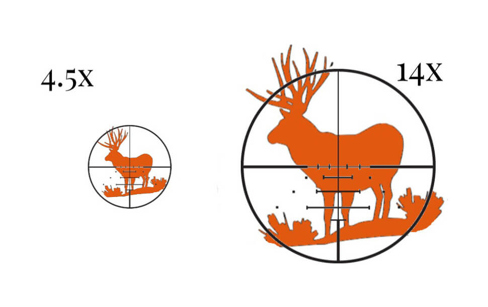

A first focal plane (FFP) scope is one in which the reticle appears to change size as you adjust the magnification. The reticle appears small when zoomed out and large when zoomed in.
First focal plane scope example
Nightforce makes a series of first focal plane scopes like this SHV 4-14×50 F1.
The major advantage to this is that the magnification of the reticle and view remain the same so that your stadia marks are always relevant. A one mil mark in your crosshairs, for example, will stay constant throughout the range of magnification.

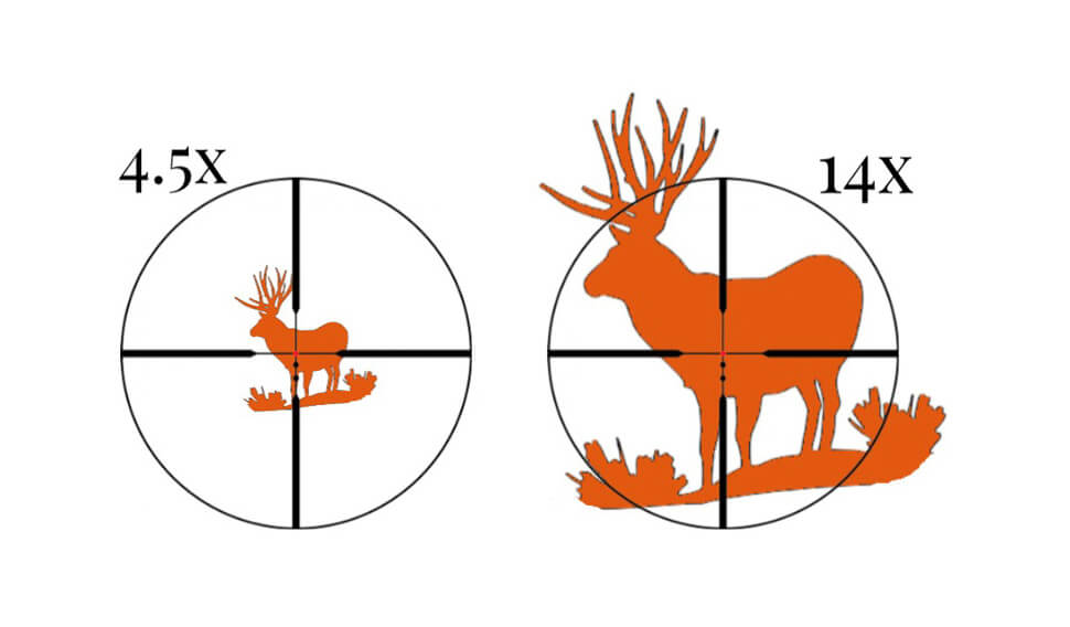

A scope with a second focal plane (SFP) reticle does not keep a proportional size between the reticle and the view. In other words, the reticle size never appears to change. It is just as large zoomed out as it is zoomed in.

Alternatively, a second focal plane scope maintains a single size of reticle throughout the magnification range. If you are running a 3x-9x scope, the reticle will appear to be the same size at 3x and at 9x even though the image increased in size.

The downside to the second focal plane scope is you can only use the stadia marks accurately at a single point of magnification. Typically, this is at the maximum magnification. In practice this means with a SFP scope, two stadia marks to the left at 3x does not mean the same thing as two stadia marks to the left at 9x.
On the other hand, the center of the crosshairs will always be on target regardless of the magnification. As long as you are able to apply some Kentucky windage at a low magnification setting, you will still be able to place an accurate round. However, for long ranges, the second focal plane scope will often take a shooter more time to make his adjustments and ensure the round is on target.
