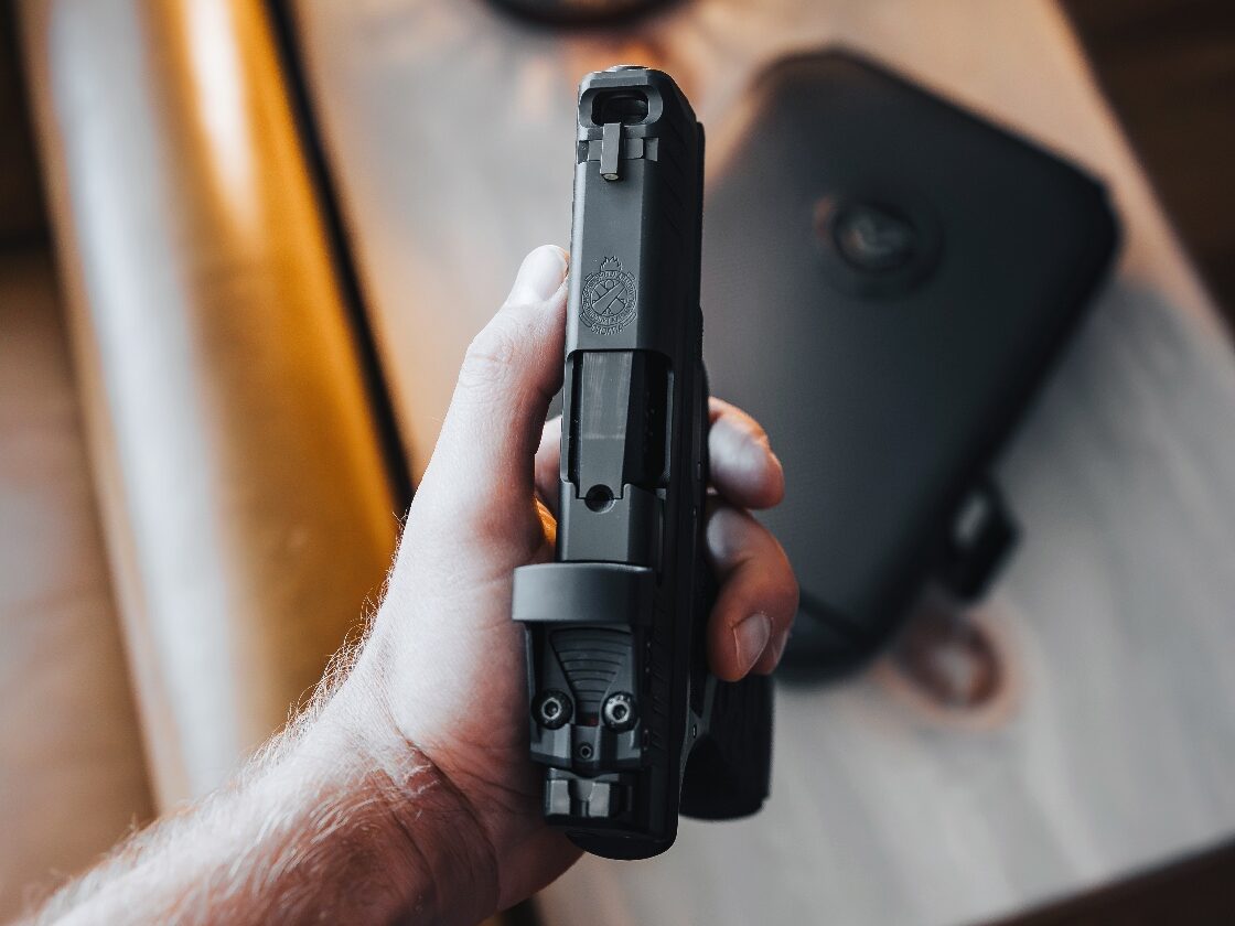

Close-up photo of a ported pistol barrel and slide. The image shows a single port on top, located just in front of the front sight. This is a built-in compensator design, not an aftermarket add-on. Gas vents through the port when the gun is fired to reduce muzzle rise and perceived recoil. The photo helps explain how compensators work in ported pistol designs. It’s relevant to the discussion of ported pistol myths and how comps affect performance in defensive handguns.
A port redirects gas upward to help reduce muzzle rise. With a pistol like the Hellcat Pro Comp, a port is machined into the barrel and slide — not attached to a threaded muzzle.

A compensator, or comp for short, is an effective way to reduce muzzle flip and reduce recoil. Handguns like the Prodigy Comp, Hellcat Pro Comp or Echelon Comp, for example, have a machined port in the top of the slide and barrel toward the muzzle just in front of the front sight. The port diverts burning gas upward as a shot is fired and, basically, helps counteract muzzle flip.
