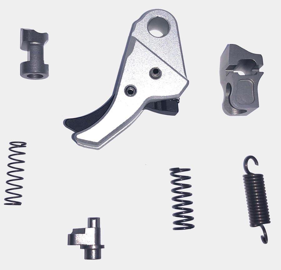

powder river precision trigger kit parts for hellcat pro
The PRP kit comes with a trigger, sear, disconnector, striker safety, two different sear springs, a disconnector spring and a striker safety spring.
As the conversation evolved, I explained to him that while I like the original trigger on the Pro just fine, I wanted a metal trigger for the pistol. And, I was curious what the PRP Trigger Kit could bring to the table. “Our goal with the kit was to get the pull weight of the trigger down to about 4.5 lbs., as well as smooth out the ‘feel’ of the pull a bit,” he said. “We accomplished this with our sear, striker safety and disconnector.”
These parts are designed to Batchelor’s exacting standards, and complement the inherent quality of the Hellcat. Both the sear and disconnector are made of 440C stainless steel, heat treated to 53-56 RC for durability. The striker safety is machined from 416 stainless steel, and also properly heat treated.
“Let’s talk about the trigger in the kit,” Daniel said to me. He went on to explain that the trigger is called the HTS, which stands for “Hybrid Trigger Shoe”. “Some people love flat triggers and some love curved, and it seems like the two sides will never agree,” he said.
“The HTS was designed to offer the best of both worlds. The flat section in the center allows the finger to be placed comfortably near the tip, while the short curved section helps to reduce the chance of ‘trigger bite’ that some shooters can experience with smaller-framed pistols,” he told me.
