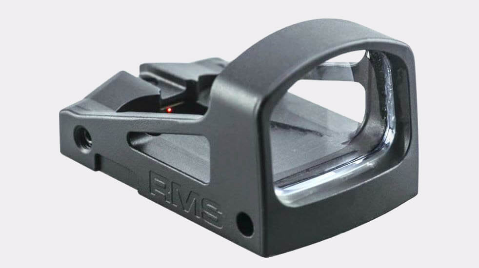

Rob has found that a red dot like this Shield RMS is a great addition on his 9mm 1911.

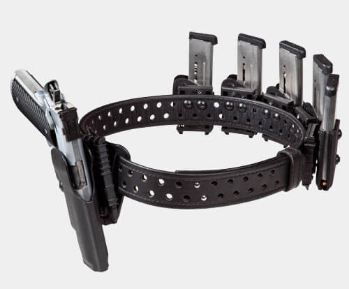

Based on what match I’m attending, I just mount whichever slide I want to shoot, put on the right shooting glasses and it’s off to the races. I am also able to use the same Safariland ELS rig with a 5198 holster and 771 mag pouches for either set-up — and that’s a huge bonus!

What you should pay attention to on my CO slide is the Shield RMS optical sight. This one is my favorite of all the optical sights right now due to its simplicity and ultra-light weight. With heavier optical sights, I can feel the added mass when the slide moves during firing. The Shield RMS minimizes this almost to the point of being unnoticeable. The sight is always on/auto adjusting, so I can just mount it and forget it. On the RMS sight, the dot is also in a similar location to where the iron sights would be, so there is no adjustment period when I switch back and forth between optics and iron sights.
On the optics-mounted slide, there are serrations on the front. This design allows for an over-the-top hand position to operate the slide. I always want to stay away from the optics lens if possible.
You may have noticed that there are no iron sights on this slide. Since I am still in the experimental phase, I am not sure yet where I will land on this issue. For a CO competition gun, I have had no need for the irons. Not as back-up or anything else. As a matter of fact, when using the Springfield Armory XD-M OSP, which does have back-up iron sights mounted, it never even occurred to me to look for the irons when I couldn’t find the dot.
I had forgotten to put a battery in the sight when I initially mounted it, and just kept looking for the never-appearing dot. With further testing though, I may like the addition of the iron sight. I’ll keep you posted…
