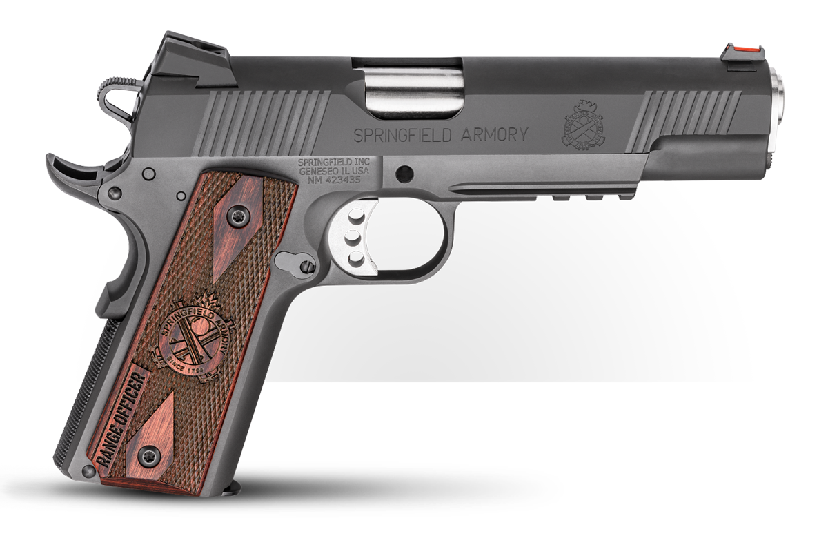

The Springfield Armory Range Officer “Operator” 9mm is a “carry” or duty-type pistol.

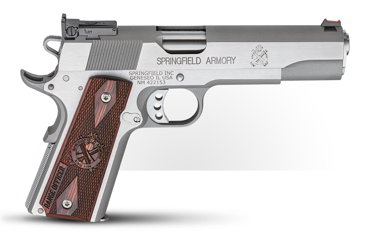

After that these two pistols differ radically. The 9mm version is carbon steel given a phosphate finish usually called Parkerizing. It’s tinted black and not green like most American military firearms. Its barrel is stainless steel. Conversely the .45 ACP is all stainless steel except for the fully adjustable Micro-type rear sight and the steel base for the fiber optic front sight.
The Springfield Armory Range Officer .45 ACP with fully adjustable rear sight would make a dandy competition pistol.
Rear sight on the 9mm is white dot cut also of steel and dovetailed to the slide for windage zeroing if needed. Obviously the .45 model is for precision target shooting while the 9mm version is more for the run and jump type of competition along with regular self/home defense or perhaps duty use. As befits that purpose it has a short rail in front of the trigger guard, machined integral with the frame. It also wears the name “Operator.”

As might be logically assumed, magazine capacity of a 9mm increases when put into the standard 1911 platform. This Range Officer Operator’s magazines hold nine rounds and it comes with an extra. The .45’s capacity is the standard seven rounds and it also comes with a spare. As also might be logically assumed, when a 1911 is crafted for a smaller cartridge than its original .45 ACP it gets a mite heavier. Although Springfield’s website says their unloaded weights are 40 and 41 ounces, I could feel that the 9mm had heavier heft. My samples actually weighed 40 and 43 ounces. The rail and extra thick 9mm barrel adds to the weight.
Magazine capacity of the Range Officer .45 ACP is the standard seven rounds. With the 9mm version it’s nine rounds.

Rear sight on the Range Officer .45 ACP is fully adjustable for windage and elevation.

Down at my shooting house I fired both pistols for groups at 25 yards with a wide variety of factory loads and handloads using both cast and jacketed bullets. Everything I tried slid through the .45 perfectly and it shot accurately with both jacketed and cast bullets. That said: it shot well with some jacketed and cast bullets. My homemade 225-gr. roundnoses from a Lyman mold #452374 were pitiful. I couldn’t keep all rounds on an 8″ black bullseye at 25 yards. Proof you should run different loads through any gun to find out what it likes best.
Front sights on both Range Officer 9mm and .45 ACP are red fiber optic tubes. Great for old eyes!
Conversely the 225-gr. roundnose cast bullets from Oregon Trail Bullet Company shot best of all things tried. Powder charge was 5.3 grains of Hodgdon HP38. As the photo shows it was just a bit over 21/2″ at 25 yards. As received, the Range Officer .45’s sights were zeroed high and a bit left at 25 yards. After group shooting a bit I adjusted them to give a dead-on zero. One good reason to have an adjustable sight.
Rear sight on Range Officer “Operator” 9mm is fixed with white dots and dovetailed to the slide for easy windage zeroing.
Things did not progress so smoothly with the 9mm, but it wasn’t the pistol’s fault and gave us another lesson about ammo. It fed several factory loads perfectly. Then I began trying some of my cast bullet handloads. On the second shot the case did not eject and the extractor tore right through it. After punching it out with a cleaning rod — it came out reasonably easily — some more of that load were tried. After a couple of shots the same stoppage happened. Again the case was punched out. This time I examined it to find bright spots around the case head about 1/8″ ahead of the extractor groove.
The Range Officer “Operator” comes with a small rail under the frame for clamping lasers and lights and such.
The 9mm was then disassembled and rounds dropped into the chamber. Factory loads just kerr-chunked home. My handloads stopped before being fully chambered. This was a slight conundrum because I have a half-dozen 9mm pistols and two 9mm submachine guns and my reloads function in all. Those 9mm handloads were put together all on one press and it obviously was not resizing the cases enough for this particular chamber. Most of my other 9mm firearms have military chambers which are intentionally generous in size.
Note the extra thickness of the 9mm’s barrel at left. That is one reason for its extra heft.
So again, this is not to mean the Springfield Operator 1911 9mm is at fault, at all. I say this to let it be a lesson to those who reload the 9mm. It’s up to the handloader to return his processed brass back to factory specs so it works in all 9mms across the board. Perhaps this is one reason self-defense/training experts advise people to only carry factory ammunition in their serious handguns.
The Range Officer .45 ACP put these eight rounds into a group of about 2¾” at 25 yards. The 9mm shot well too.
Anyway, I can say that after opening an old box of Winchester 115-gr. Silvertips the Range Officer 9mm started to behave and shoot clusters. Either it preferred that type of load or it was getting broken in; I am not sure but it began shooting very well. No complaints at all when I got smart and stuck to factory loads! And one thing I can say for sure — this heavyweight 9mm is a pussycat in the recoil department. My arthritic hands liked it a lot!
