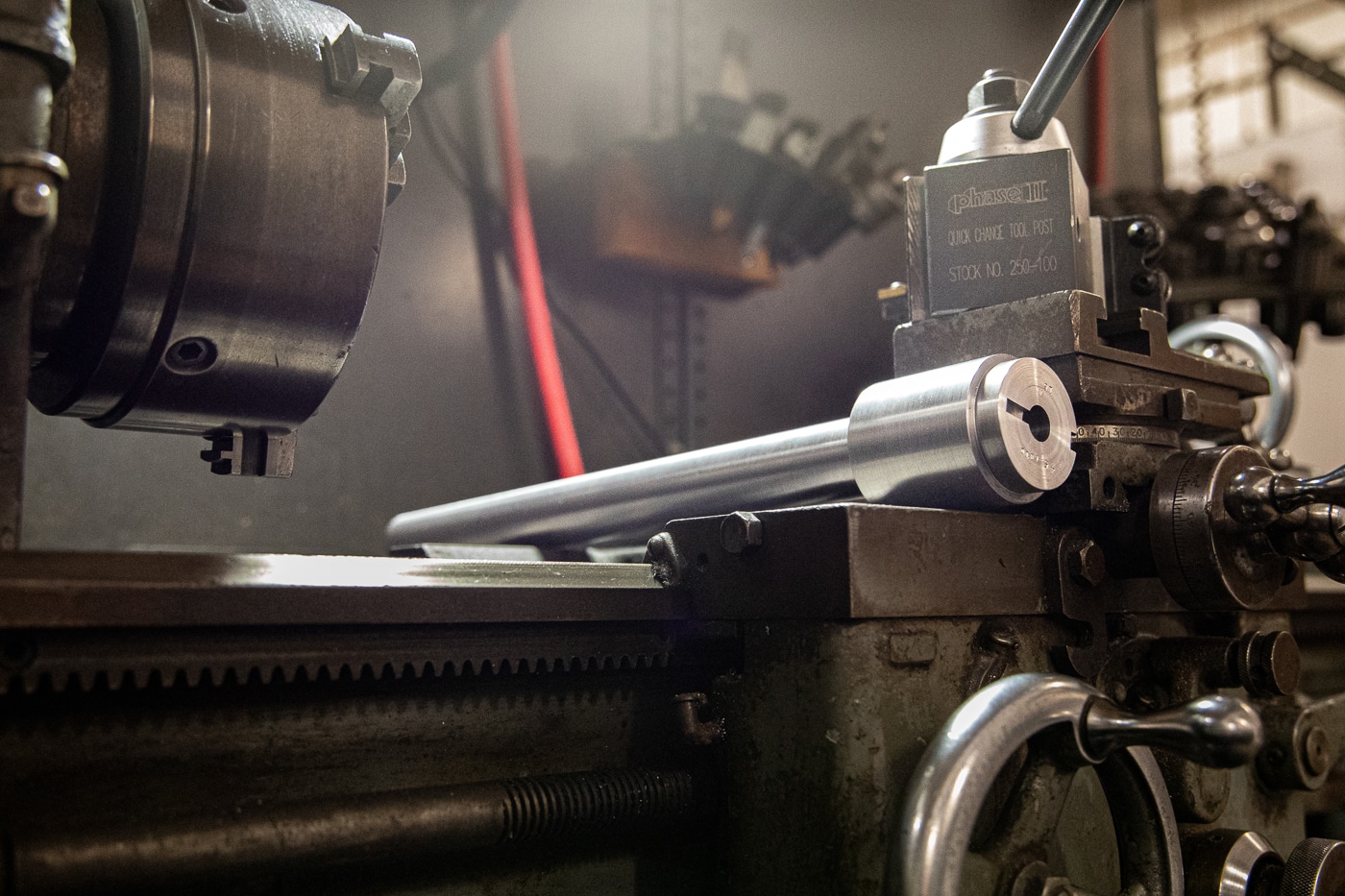

A pressure barrel and the lathe that was used to produce it. The pressure barrels are made on site by Lyman. Image: Harrison Rice

lathe and pressure barrel
A precision lathe is used to produce precision test barrels. The barrels are an integral part of working up safe loads for handloaders. Image: Harrison Rice
