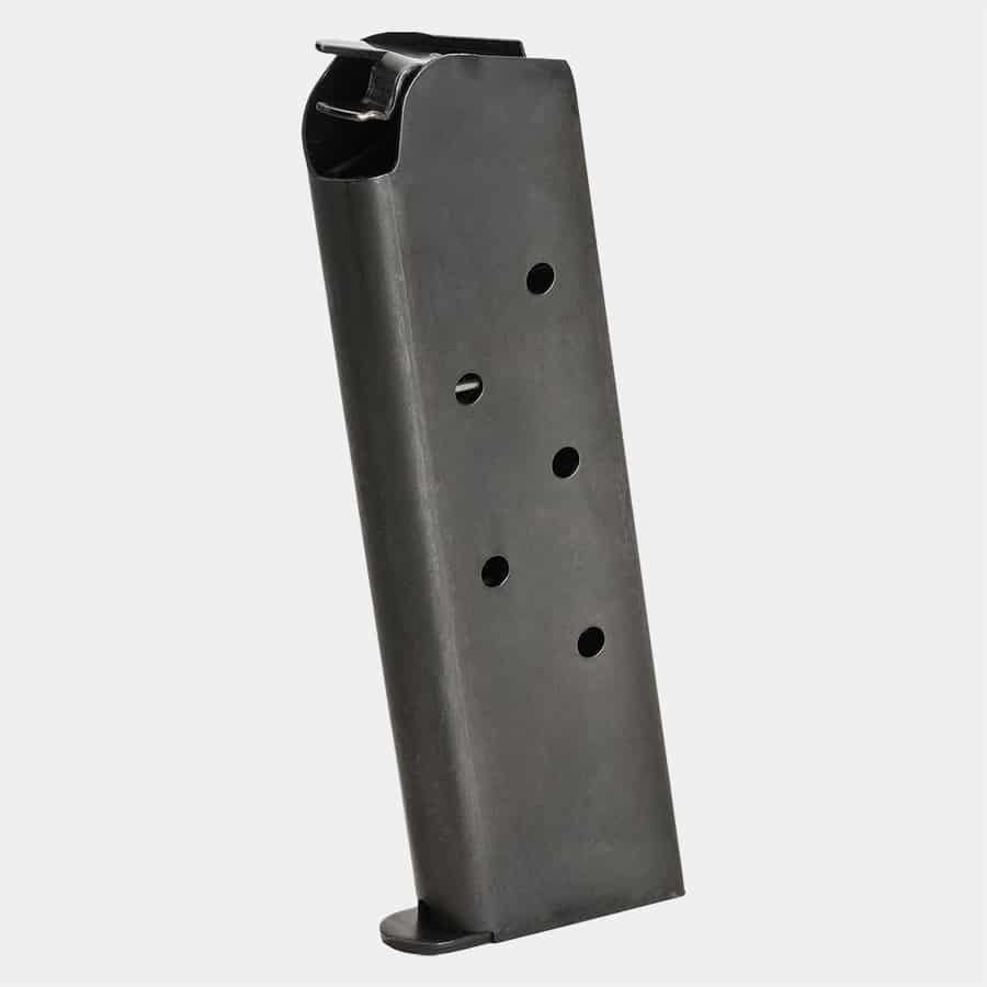

Here is the testing routine I go through when I get new mags, am preparing for a major match, or when I have magazines that just haven’t seen much attention or use from me. Today I’m testing my Springfield Custom 9mm 1911 Single Stack (that I use for competition) with three new 10-round magazines:
mag testing
Magazines are a potential point of failure in any handgun. If the lips are bent or the springs weak, malfunctions may happen.
