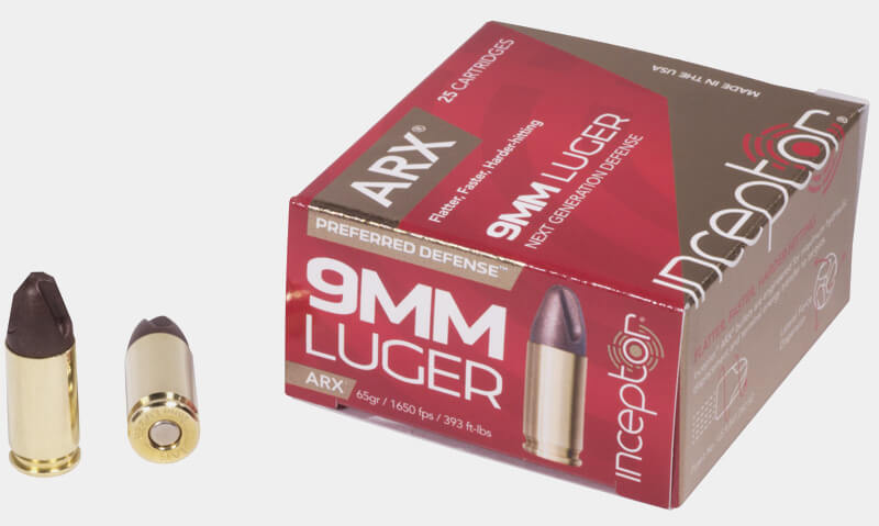

Inceptor’s ARX features an injection-molded bullet with three flutes and a blend of copper and polymer materials. The bullet design is meant to deliver devastating kinetic energy, particularly on tissue by creating maximum hydraulic displacement. This works through centrifugal motion, which in turn causes lateral force dispersion. In other words, energy gets dumped rapidly around the bullet as it enters the target. One of the positives of the ARX loads, particularly in 9mm, is that they’re soft recoiling and ideal for massive quantities of training.
Inceptor 9mm ammunition
Inceptor’s ARX features a lightweight injection molded bullet that blends copper and polymer.
