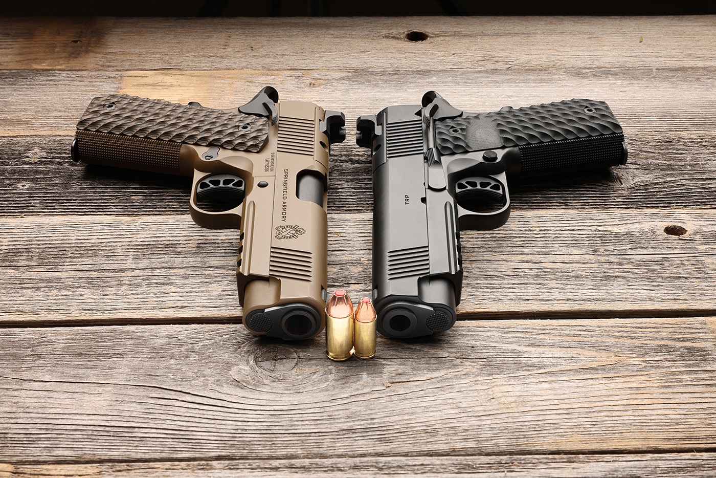

Despite the 9mm Luger cartridge being currently much more popular than the .45 ACP, the debate as to which is the best self-defense round continues. It is pretty much conceded that the 9mm pistol can hold more rounds in the same-size package, and it’s undeniable that in similar-sized guns, the 9mm will have distinctly less recoil. It is likewise uncontested that 9mm practice ammo is much more affordable than that for .45 ACP.
Two Springfield Armory 1911 pistols displayed side by side. One is chambered for 9x19mm Parabellum, known for higher capacity and lower recoil in smaller calibers. The other pistol is chambered for .45 ACP, recognized for its larger projectile and potential stopping power. Both pistols feature identical adjustable iron sights and similar trigger pulls, making them ideal for a direct caliber performance comparison. They are similarly weighted, allowing for an unbiased test of shooting capability between the two calibers. The comparison highlights the ongoing debate between the benefits of higher capacity and control versus larger caliber stopping power. This visual aids in understanding the practical differences evaluated in the article.
Can you hit your target twice as fast with a 9mm as you can with a .45 ACP pistol? The author explores the reality of getting faster hits by going with a lighter cartridge.
