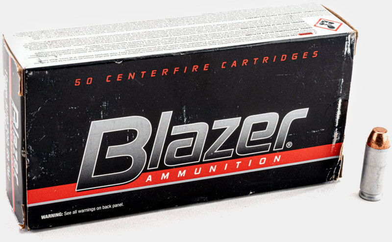

With the Blazer load, the FMJ punched clean through all 32″ of the gelatin, and impacted heavily on the safety berm behind it.
Excessive penetration is generally not preferred for defensive ammunition. While FMJ loads are great for paper targets, they simply do not expand in an attacker and will generally overpenetrate as this 10mm gel test shows.

I also chronographed all three 200-gr. loads to see how they performed. The Federal HST came in at an average of 1,130 fps, the Speer Gold Dot at 1,100 fps, and the Blazer ammo at 1,030 fps.
10mm Blazer FMJ ammo for target practice
Yamil also threw some Blazer 200-gr. FMJ ammo into the mix. When comparing self defense loads with FMJ, the ball rounds will almost always overpenetrate.

The two hollowpoints expanded nicely and stopped at around 18″ of penetration. The FMJ round blasted through all 32″ of the gel.
