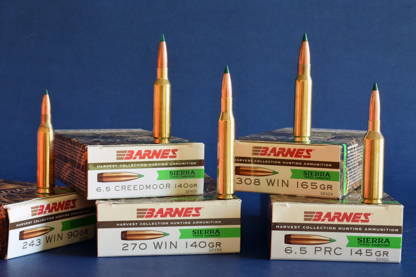

A close-up view of several boxes and individual cartridges from the Barnes Harvest Collection, loaded with Sierra Tipped GameKing bullets. Each cartridge is neatly positioned to display the brass casing, polymer-tipped projectile, and clean manufacturing finish. Visible calibers include options for .223 Remington, .243 Winchester, 6.5 Creedmoor, and .308 Winchester, among others. The arrangement is on a neutral background, highlighting the shiny brass and distinctive bullet tips. The image emphasizes the variety of loads offered in this line. It reflects the brand’s focus on deer-hunting performance and quality ammunition construction.
Barnes’s Harvest Collection ammo with Sierra TGK bullets includes these popular loads, and four additional ones.

Back to the Harvest Collection. At this writing, it comprises nine cartridges, with TGK bullets in weights appropriate for deer-size game. They’re sleek missiles. The 69-grain .223’s ballistic coefficient is not quite .380; the 90-grain .243’s is .490. BCs of the others top .500. Herewith, exterior ballistics figures:
