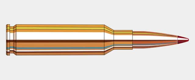

No scope can be tested without an accurate rifle, so we chose the Springfield Armory Model 2020 Redline chambered in 6.5 Creedmoor. In our experience, the Redline chambered in 6.5 Creedmoor has been a sub-1/2 MOA gun with the Hornady Precision Hunter 143-gr. ELD-X ammo we used to test the scope.
