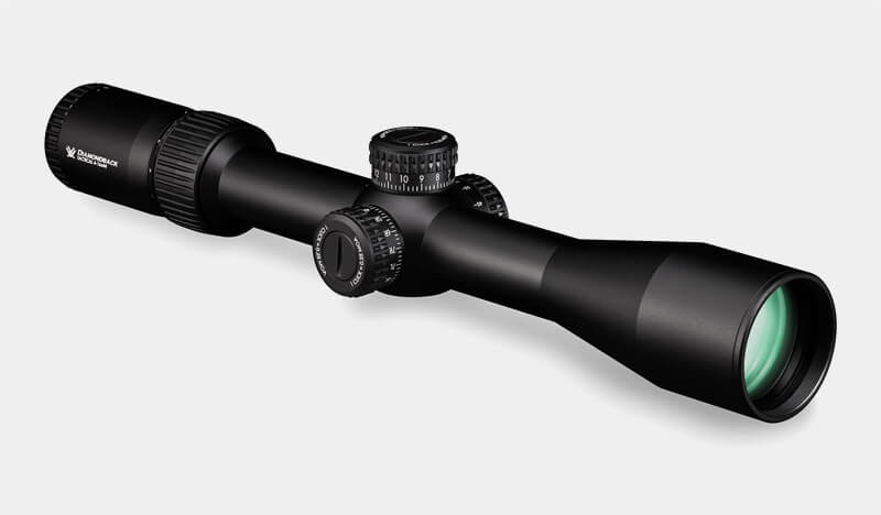

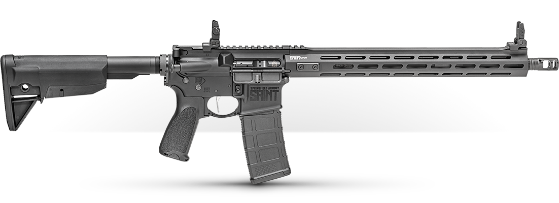

Mounting an optic properly and getting it set up for the range doesn’t have to be a complicated process. To show you how simple mounting a rifle scope can be, I’m going to fit a Vortex 4-16X Diamondback Tactical scope to my Springfield Armory SAINT Victor rifle. To mount a rifle scope, you only need to use some basic hand tools.
