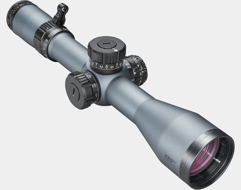

For our test, we have two scopes that are sighted in on our Model 2020 Waypoint. We have a Bushnell Match Pro and a Bushnell Elite Tactical XRS II. The idea is that you can swap scopes as much as you want and, as long as everything you have features good quality parts and gets replaced in the same spot, your zero will never be lost.
To start, we had the Match Pro mounted up and we took it off and put on the XRS II. It’s important to remember where the scope sat in the Picatinny rails also when mounting your scopes. Set them in the rails and then push them all the way forward in the slot.
After we tightened it down using our torque wrench to the specified setting indicated by Badger Ordnance, we fired a few shots. All of our shots ended up inside a 1” square at 100 yards, with all the shots practically being on top of one another. Next, we un-mounted the XRS II and put on the Match Pro, and fired a couple of shots. We noticed the same thing — we were able to put shots inside a 1” square at 100 yards.
