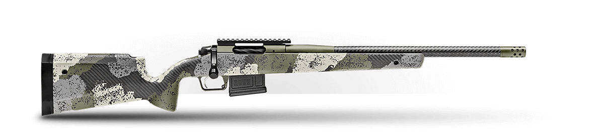

carbon fiber barrel on springfield hunting rifle
Springfield Armory offers several Model 2020 rifles with carbon fiber barrels suitable for hunting and other shooting applications.
There are two things you notice immediately with carbon fiber barrel rifles. The first thing is weight. Rifles fitted with carbon fiber barrels are on average a pound or more less heavy than the same rifle with a steel barrel. The second thing is cost. Carbon fiber barrels easily cost twice that of a steel barrel.
So, is a carbon fiber barrel worth the cost? If you hunted the backcountry you know that any added weight grinds you down. In my opinion, I want a carbon fiber barrel – especially in the instances when my outfitter says we need to climb that hill while toting a rifle. That “hill” looks more like a mountain to me. Ask any backpacker and they will say the less weight the better.
