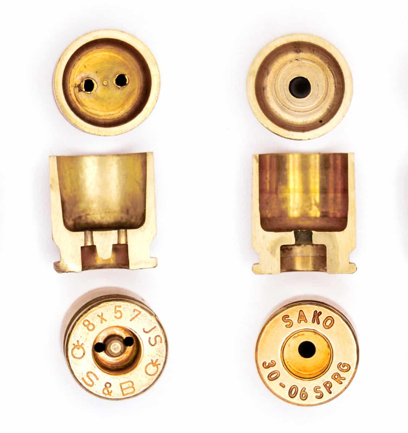

Corrosive ammunition uses Berdan primers, which are less expensive to manufacture and are commonly found in military surplus ammunition.
Berdan Primers were named after their inventor, Hiram Berdan, who patented his design in March 1866. Berdan primers are pressed into a primer pocket and rest just below the base of the casing. Inside the pocket is the anvil, with two holes on either side, which allows the ignition from the primer to enter the casing.

Boxer primers were patented in October 1866 by Colonel Edward Mounier Boxer of the Royal Arsenal, England. Since these primers do not contain corrosive salts like Berdan primers, they are less likely to cause any damage to your firearms if they are not cleaned immediately.
