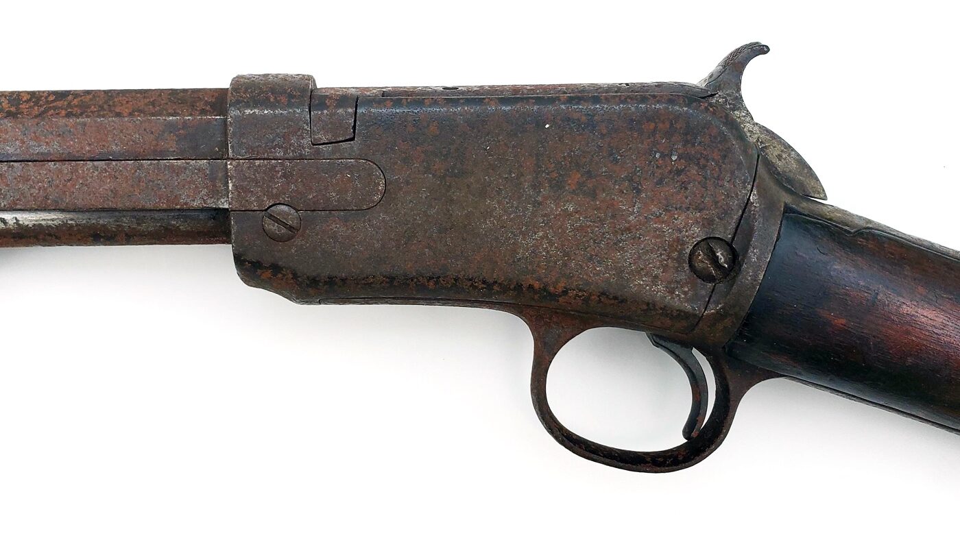

A close-up image of a pump-action .22 rifle receiver with obvious surface rust covering part of the metal. The rust appears as orange and brown discoloration along the side of the receiver, showing the effects of moisture and neglect. The rest of the rifle, including the wooden stock, is partly visible in the background but out of focus. This photo illustrates the kind of rust damage that can happen if a firearm is stored improperly or not maintained. The main purpose of this image is to show readers that rust can be removed from a gun using common techniques and tools. Taking action quickly can stop further corrosion and preserve the rifle’s function and appearance. The photo supports the primary keyword, “how to remove rust from a gun,” and demonstrates what surface rust looks like before cleaning.
This old .22 pump rifle has seen better days. Addressing rust issues can stop additional corrosion and keep your firearm in a safe, usable condition.
