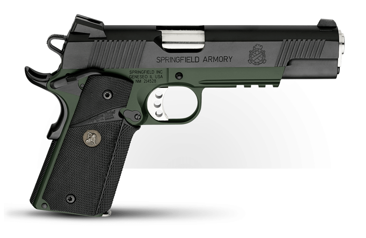

In hand, the Never Unarmed 1911 magazine has a quality feel to it. The owner of the company, Lynn Thompson, told me he has run more than 5,000 rounds through the magazines and they still work perfectly. I had 500 rounds and a handful of different 1911s for my test, so I decided to see how the magazine would perform for me. Most of the shooting was with the Springfield Armory Loaded Marine Corp Operator.

The slides on the Marine Operator and the other 1911 pistols I used all locked back. Reloads were smooth and quick. The Never Unarmed mag tube is slick when inserted in the pistol, and that no doubt helped. The magazine seated every time with either a slap from the palm of my hand or a slow press with my fingers. In total, I estimate I put 500 rounds through the Never Unarmed magazines and didn’t experience a single hitch.
