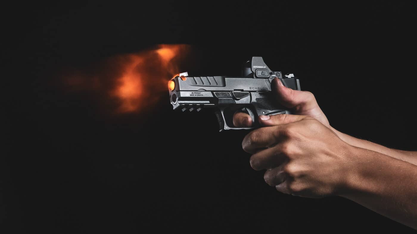

Action photograph capturing proper pistol grip technique on a Springfield Armory Echelon during shooting practice. Both hands work together with the dominant hand positioned as high as possible on the backstrap and support hand providing complementary pressure on the opposite side. Thumbs are oriented forward along the frame without interfering with external controls or slide operation. The grip demonstrates how fingers tightly encircle the grip frame while maintaining trigger finger placement on the trigger face. Establishing this type of firm two-hand grip connection to the pistol is foundational for defensive-style shooting success. Proper hand placement and grip pressure directly impact your ability to control recoil manage muzzle flip and deliver accurate shots on target.
Your grip is the foundation of accurate defensive shooting, yet it remains one of the most overlooked fundamentals.

Most modern pistols have very pronounced tang on the backstrap with a recessed area below it. This indented area will be our point of reference. Index the web of the hand between the thumb and index finger and take a firm grip as high as possible on the backstrap. By taking a high grip, it brings the long bones of the arm as close as possible to the axis of the bore to the pistol, which will minimize muzzle flip. This is a very important quality when there is a need to fire fast, subsequent shots on the target.
A second point of contact is made by getting the side of the large knuckle of the middle finger in hard contact with the underside of the trigger guard. This helps mitigate muzzle dip when shooting at speed. The thumb, middle, ring and little finger tightly encircle the grip frame.

Once you establish the dominant hand on the pistol, it’s time to get the support hand into the act. Place the palm of the support hand on the opposite side grip panel, trying to establish as much contact as possible.
Like many shooters, I favor a thumbs-forward grip when shooting an autopistol. The support is placed underneath the dominant hand thumb, as high as possible on the grip panel. I know of many highly skilled shooters who like to angle that support side wrist down when establishing the grip, but I find it uncomfortable and prefer a more neutral position.
