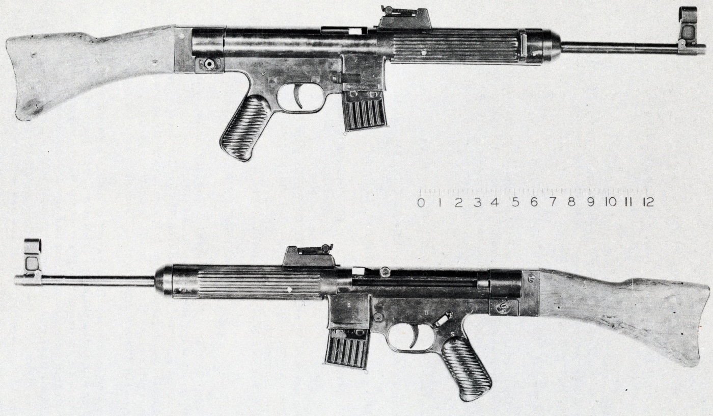

The image shows a German StG 45(M) assault rifle prototype chambered in 7.92x33mm Kurz. The rifle is fitted with a compact 10-round detachable magazine instead of the more common 30-round version used in the Sturmgewehr 44. Its stamped steel receiver and plain wooden stock emphasize the utilitarian, late-war German design. The inline stock and sights directly over the barrel highlight the rifle’s improved controllability and accuracy in automatic fire. This experimental weapon was never mass-produced, though parts for about 30 rifles were completed. The 10-round magazine was reportedly used by Mauser engineers for convenience during testing. The StG 45(M) later became the foundation for postwar roller-delayed rifles such as the CETME and HK G3.
The StG 45(M) chambered for the 7.92x33mm Kurz cartridge with a 10-round magazine. Image: U.S. Army Ordnance Museum

The StG 45(M) continued the use of plentiful stamped and pressed steel components, while fit and finish remained completely utilitarian. Similar to the FG 42 paratrooper’s rifle and the Sturmgewehr 44, the StG 45(M) was an early “inline” rifle; its shoulder stock and center of gravity were directly inline with the bore.
The sight line directly over the barrel helped make the StG 45(M) more accurate, easier to control on full-auto, and faster to learn — all important factors for German forces starved for capable fighting men. The StG 45(M) was to be a complete rifle for the infantry.

The original prototype, the MKb Gerät 06 (“Machine Carbine 06”), used a unique roller-locked mechanism adapted from the MG 42. Initial tests showed a troubling tendency for “bolt-bounce,” and Mauser designers addressed the problem with a roller-delayed blowback system. This became the “Gerät 06H” (half-locked), and eventually received the designation of Sturmgewehr 45(M). The unique roller-delayed blowback action was patented by Mauser’s Wilhelm Stähle and Ludwig Vorgrimler.
The StG 45(M) was to use the same 30-round magazine as StG 43/44, but it is almost always seen fitted with a small, 10-round magazine. Apparently, the Mauser engineers found the 10-round magazine more convenient when test-firing Sturmgewehr 45 prototypes at the Mauser ranges. Some reports claim that the 10-round magazine was intended for the Volkssturm militia — which would speak to Germany’s prevailing ammunition shortages and the desire to use the Sturmgewehr rifles in the semi-automatic mode as much as possible.
