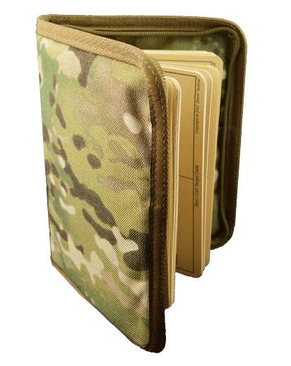

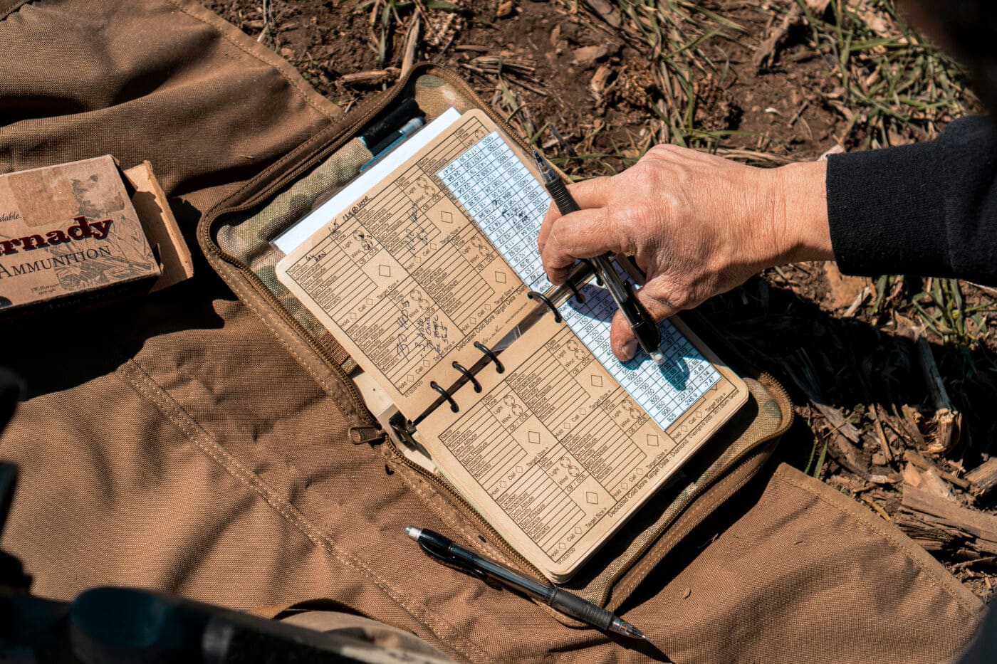

![American Snipers Data Book](https://www.thearmorylife.com/wp-content/uploads/2022/09/American-Snipers-Data-Book.jpg)
Now your DOPE is perfect and you will never miss! Right? Wrong. Now you need to work your way back in at some other distances and try testing it farther out. But you should be much closer to fully understanding your rifle now.
After you have trued your data further, Grant suggests writing it down, typing it up, printing it off and carrying it with your long distance gear. Now, in theory, who even needs a computer if you’re shooting around the distances you have mapped? That’s not entirely true, so don’t toss your ballistic computer in the trash just yet. The computer still serves a purpose, and now that you have trued the data it will be that much more accurate.
