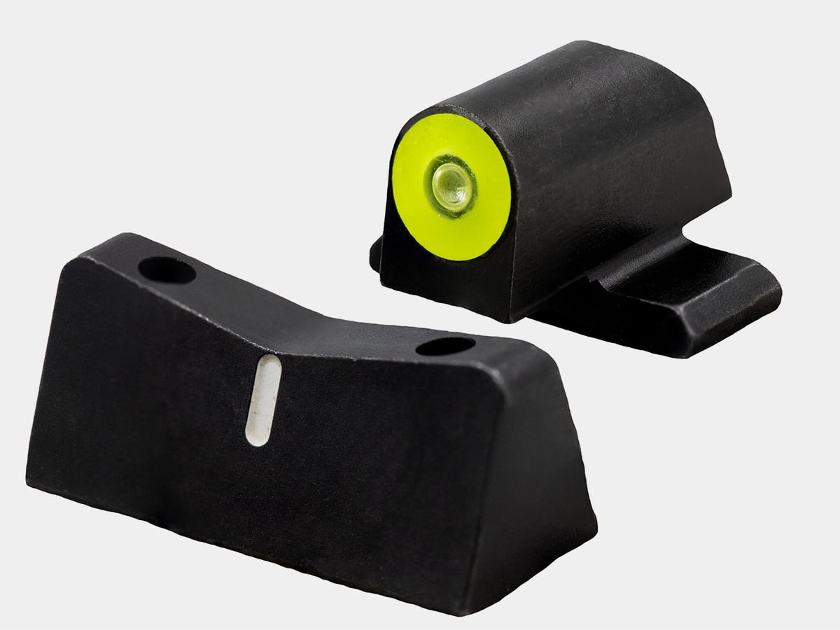

XS Sights has been offering an alternative to the traditional three-dot sight picture for some time. Called the “Big Dot Night Sights”, they consist of an oversized front dot and simplified rear sight that has only one mark — a vertical post.
xs sights dxt2 big dot night sight set
XS Sights offers a range of sight replacement options for the XD-S, Hellcat and other Springfield Armory pistols.
I tested this alternate sight combination by installing the DXT2 model sights with a yellow front dot on my XD-S Mod.2 OSP 9mm. They are also available with an orange dot. They are available for most handguns, including the full line of Springfield Armory’s XD series of products. To make this a test relevant to today’s handguns, I chose to put them on my XD-S OSP and then co-witness with the red-dot optic.
