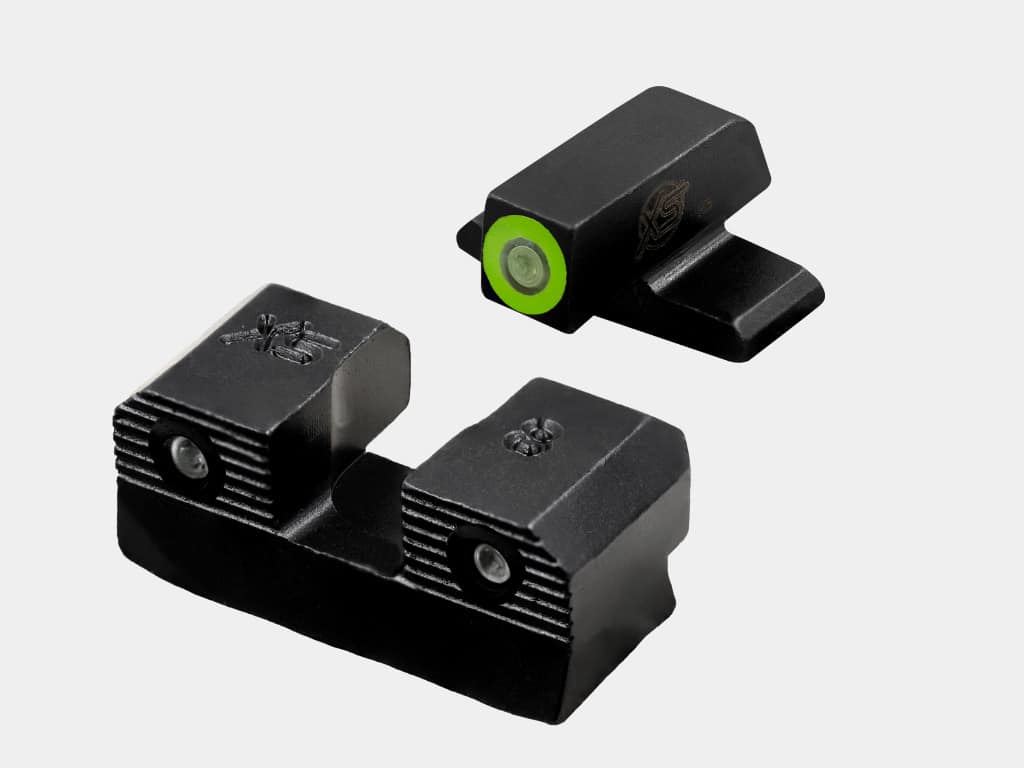

This is the two piece XS Sights night sight set. The iron sights use a photoluminescent glow dot in the front sight with tritium vials in both the front and rear sight. These were reviewed on a Springfield firearm but they are also made for Glock and other handguns.
Shown is the complete XS Sights R3D tritium night sight set that the author installed on his pistol. The combination of tritium with the photoluminescent ring offers good low-light performance for CCW.

The R3D 2.0 sights from XS have a front sight with a large fluorescent ring surrounding a tritium dot, all housed in a high-quality dovetail mounted blade. The rear sight is low profile with a serrated back surface that encloses two tritium dots on either side of the square notch. Together, they provide a sight picture that is both quick to acquire and easy to align on target.

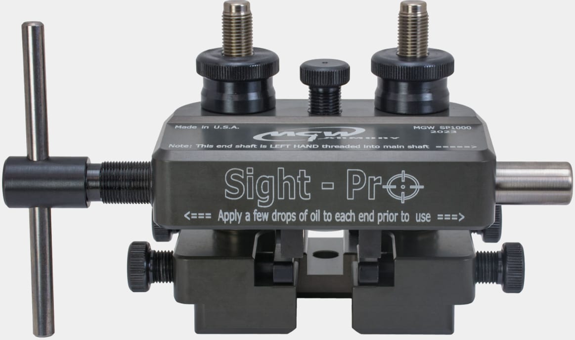

Obviously, the first step is to remove the existing sights. Keep in mind that factory-installed sights are going to be very tight and likely have adhesive under them. I use the MGW Sight Pro tool and put it in a vise on a sturdy bench. Even then, I usually have to wear gloves to be able to apply the force needed to break the sights loose. Using a leverage extender, like a pipe or wrench handle is verboten as it will void the warranty of the tool.
My next tip is to drift the sights out and in from the same side of the slide. This is a best practice and will help keep one side of your dovetail looking pristine. Because there are so many different tools and methods, I won’t go into further detail, but keeping everything steady and tight lets the energy be focused on pushing the sight. Be sure things are level and straight before you apply any force.

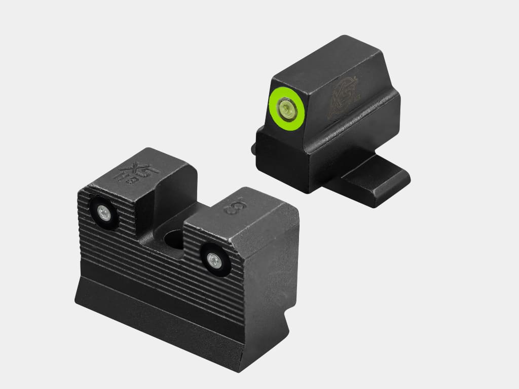

The rear sight has a pair of tritium vials that glow in the dark. The black, serrated face reduces glare in bright light. The sight also is standard height and not suppressor-height sights. For most shooters, this is perfect as few people attach a silencer to their concealed carry gun.
The rear sight process is virtually identical with just a few differences. Centering the rear sight can be more difficult due to the width of the sight and the angles of the slide and sight shapes. The XS rear sight is designed to be installed from right to left, as viewed from the rear of the slide. My cheat is to use the edges of the rear striker cover plate to align my rule and center the sight notch based on that. The final test of course, is firing live rounds at a target!

I promised I’d get back to the quality of tool to use. The MGW Sight-Pro is several hundred dollars to purchase, and requires precision “shoes” for each brand or model of pistol you wish to work on. It can quickly become a $400-500 investment. Unless you plan to do a lot of sight installations, it might be hard to justify that cost. There is no shame in finding a local gunsmith or full-service gun shop that will install them for a reasonable fee. It’s also a great way to build a relationship with that store or gunsmith and support the local business. I’d recommend that over trying to use an inexpensive tool that you find online. And unless you’re very skilled and experienced, I also do not recommend the hammer and punch method.
