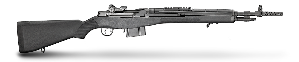

What do you get when you start with a Springfield Armory M1A Scout Squad in basic factory trim and send it to ROBAR for the “Full Monty”? Read on, and you’ll find out.
It will come as no surprise to regular readers that we consider the Springfield Armory M1A Scout Squad to be one of the finest .30-caliber defensive carbines money can buy. And that’s why most of us here at On Target own one of them. The M1A Scout Squad is a relatively light (8 lbs. 4 oz.), eminently rugged, battle-proven design, and its 7.62 NATO cartridge packs a major punch, generating roughly two and a half times the muzzle energy of the 5.56 NATO round. If it really needs killing — from North American big game to threats of the two-legged, dirt-bag kind — then 7.62 NATO will produce the desired results.

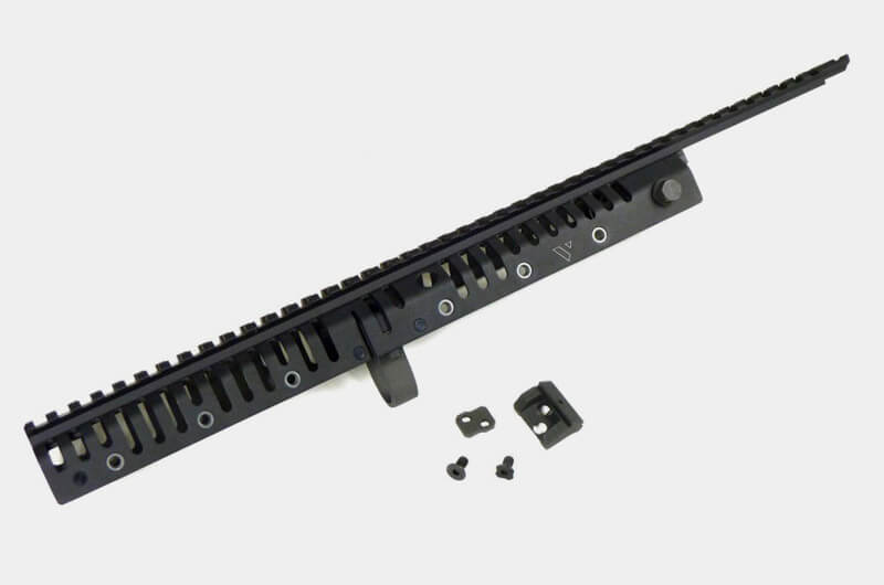

To create a full-length top rail we chose VLTOR’s CASV-14 upper handguard assembly ($325.95). It features a one-piece, extended-length top rail that runs from the gas cylinder all the way back over the receiver. It is secured at the rear by the dovetail for the rifle’s stripper clip guide; in the middle at the rear of the barrel; and forward at the operating rod guide — a super-rugged mounting system that permits the barrel to free float over the majority of its length. Machined from aerospace-grade aluminum, the CASV-14 is vented along both sides, and includes three side flats with threaded holes for mounting optional 5-inch Picatinny rail sections. Even though our vision for the finished rifle was a flat dark earth treatment, we ordered all the VLTOR components in black as we wanted to see how well the various ROBAR metal and plastic finishes we had in mind would match.
The VLTOR CASV-14 upper handguard features a full- length top and offers multiple mounting points for Picatinny rails. Aimpoint optic is coated in Polymax.
