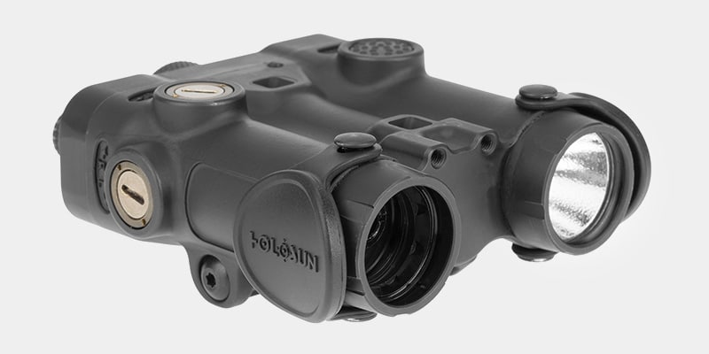

I also got one of their “holy grail” LE420 multi-laser aiming device units that can be difficult to come by. The LE420 is a multi-laser aiming device with a 600 lumen white light, a Class IIIA visible green laser, class 2M IR laser and a focusable IR illuminator — all housed in a titanium body. MSRP of it is $1,411.75.
holosun le420 laser and ir illuminator review
Boasting IR and white light illumination along with an IR and a visible green laser, the Holosun LE420 is a capable piece of gear for night shooting.

One thing that separates the LE420 from other laser aiming devices is the inclusion of a white light. This is a nice benefit for firearms with limited rail space, and it offers both weight savings and possible cost savings. The only potential downside is that you cannot easily switch between IR and white light on the fly with a multi button switch, and you could put a more powerful dedicated light on (if you have the rail space).

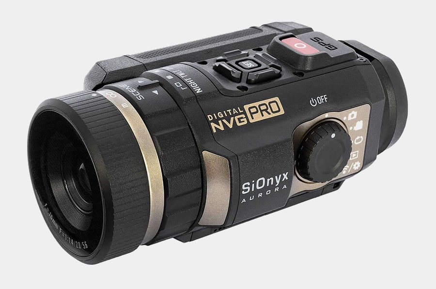

Another awesome tool for night vision shooting is the Sionyx Aurora Pro. The Aurora is a digital night vision capture device that makes filming a shoot much easier. While digital is still catching up to traditional Gen 3 night vision devices, it’s still very impressive and does the job quite well in my experience. Another added benefit of the Sionyx is that it is full color. MSRP on the Pro is $999.

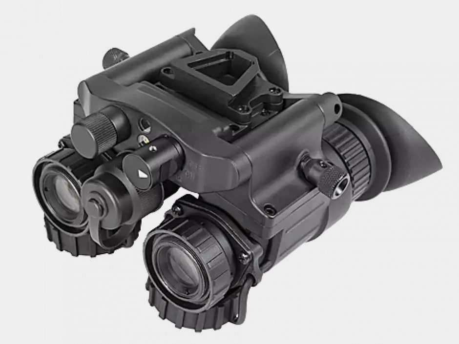

Zeroing both the optic and laser was easy with the included tools, and after zeroing we were ready for some nighttime fun. The dual-tube NVG-50 NL2 night vision goggles I used were from AGM Global Vision. Having dual tubes makes a huge difference in being able to see a wider field of view and have more awareness of your surroundings.
nvg-50 nl2 goggles review
To go with the Holosun gear, the author used the dual-tube NVG-50 NL2 night vision goggles from AGM Global Vision.
The night we were on the range there was no moon in the sky, so we were relying fully on the IR for the majority of our illumination of targets. We were shooting from about 45 yards on steel most of the night at the event. The LE420’s IR flood was bright enough to easily identify the steel target, and the IR laser was very intense. This made it easy to make hits even out past 100 yards. The unit’s white light was a nice big floodlight that would be perfect for illuminating interiors. The visible laser of it is green, so that proved to be very discernable as well.
