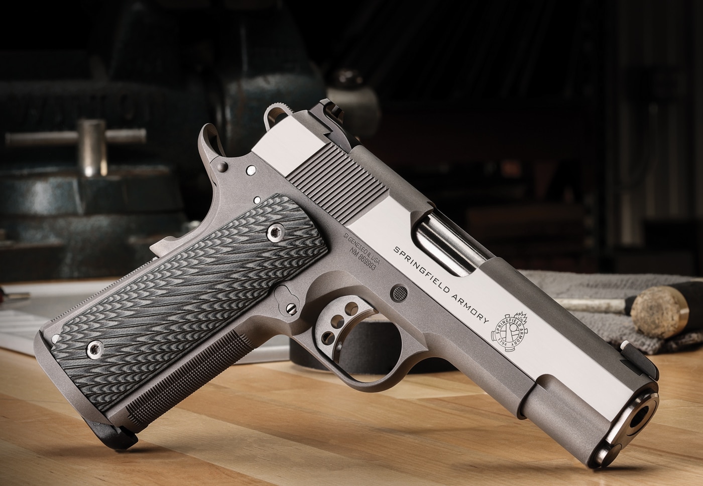

HS Custom Garrison on bench
The custom Garrison that resulted exhibited a great deal of attention to detail, from the cut checkering to the newly fitted parts. Image: Carson McDaniel/Springfield Armory
