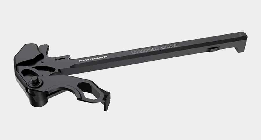

Springfield Armory LevAR charging handle out of gun
The LevAR is slightly bulkier than a standard charging handle and adds 1.7 oz. of weight. It is shown here with the lever arm open.

To deploy the LevAR’s lever, simply depress the button on the right wing of the charging handle and fold the lever from the left to the fully open position.

Springfield Armory has developed a solution for this issue. The new LevAR is a patented, AR charging handle that offers a sophisticated solution to the problem of a stuck case. It’s pronounced just like the word “lever”, but the AR signifies its use in the AR-15 platform. The LevAR is more than just a clever play on words. It’s also a clever device that uses physics to solve the stuck case issue.
LevAR installed in rifle
When deployed, the arm of the LevAR doesn’t get in the way of running the rifle. It is potentially one of the best upgrades you can make to an AR.
Weighing in at 2.8 oz., the LevAR packs a punch well above the weight addition of just 1.7 oz over a standard charging handle. The main body of the charging handle is aluminum and, just like a standard charging handle, the latch that holds the handle in the closed position is steel. On the LevAR, the lever, the cam and the push button are all steel. This is the material that adds to the overall mass of the part. At the same time, the fact that these additional parts are steel adds to the strength of the lever and the camming mechanism.
When you don’t need the LevAR, it works just like a regular charging handle — and a good one, at that. It’s when you experience a stoppage due to a stuck case that the LevAR truly stands out. And at an MSRP of $99, it won’t break the bank.
The Process
The LevAR uses a lever (actually several) and a cam, to add mechanical advantage when operating the charging handle. When faced with a stuck case stoppage, instead of mortaring the rifle you can simply deploy the lever on the LevAR and quickly remove the stuck case.
LevAR charging handle next to SAINT rifles and magazine
The Springfield LevAR is a drop-in replacement for any standard AR-15 charging handle including those found on the SAINT rifles.
The first steps are just like mortaring the rifle. First, recognize the malfunction. Next, move the selector to “SAFE.” Third, “Slap, Rack.” When you discover that the charging handle is stuck, that’s when you change course. Simply depress the spring-loaded pin on the right side of the handle and flip out the lever on the LevAR. Brace the buttstock on your shoulder and then rip the LevAR to the rear. The charging handle will follow your firm pull and the case will come free.
The added leverage provided by the LevAR’s camming lever delivers the brute force needed to pull that stuck case from the chamber. To get the rifle back into play, simply close the LevAR, get a new round in the chamber, and you are ready to go.
