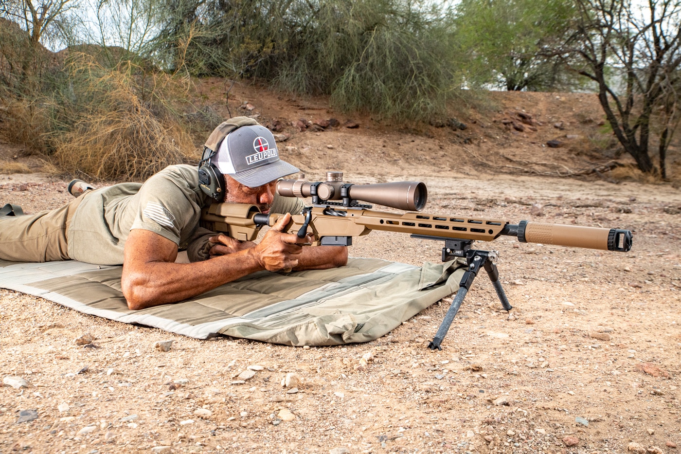

The Heatseeker comes with a threaded barrel, so it’s ready for suppression. I obliged with the addition of one of the best precision-focused suppressors to be created — the Elite Iron Asset. This .30-caliber suppressor is modular with additional baffle elements and different end caps. I set it up in its short version with the muzzle brake attached on the front-end, bringing the total length to 8” overall. While I can add some length for more suppression, I wanted to keep the rifle as short as possible while maintaining suppression and a good level of recoil reduction.
A shooter lies in the prone position behind the Springfield Model 2020 Heatseeker, firing a suppressed 6.5 Creedmoor load. The rifle is stabilized on a bipod and rear sandbag. Ejection is clean, and spent cases land consistently. The suppressor reduces muzzle blast and helps keep recoil manageable. This setup was part of the real-world evaluation for the Springfield Armory Model 2020 Heatseeker review.
Shot from prone with bipod and rear bag, the rifle handled recoil well. The suppressor helped tame the bark.
Suppressors that have muzzle brakes aren’t as quiet as their standard closed-end configurations, but a good one gives solid recoil performance while giving up only a little bit in the way of noise reduction. To me, the trade-off is worth it as I always (as you should too) wear hearing protection while shooting suppressed — especially with centerfire rifles.
With all my added accessories, including an MDT Ckye-Pod bipod, the Heatseeker hit the scales at 13.1 lbs. For the intended purpose, this is perfectly acceptable for a general set-up with leeway to go lighter if necessary and heavier if desired. This latter point is why I like the M-Lok slots on the forend of the rifle — I like to shoot a heavier rifle for general target use.
A 13-lb. rifle can be somewhat light for extended shooting sessions, but the M-Lok forend will allow you to add weights to the front of the rifle to curtail some of the recoil and smooth things out a bit. You can add or remove them as necessary, making this rifle effectively modular. If you want to go light, go light. If you need the heft, add it. It’s a win-win for the owner/operator.
