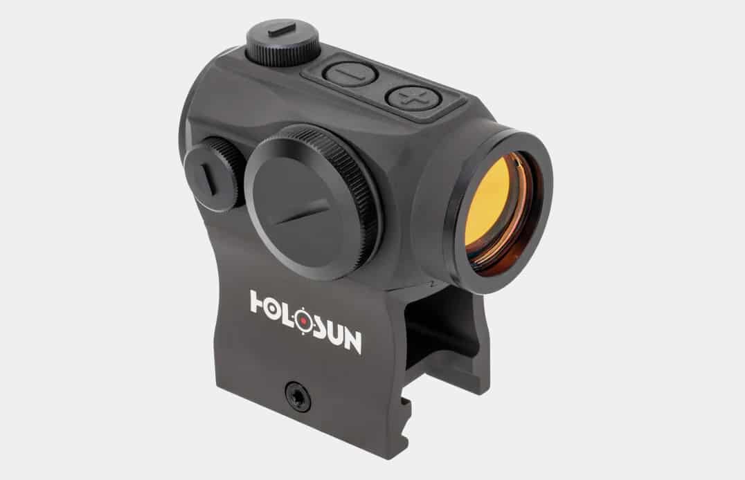

We here at GunSpot were lucky enough to get in the exclusive Primary Arms Holosun 503G with the ACSS CQB reticle. For those not familiar with this optic, it was made exclusively for Primary Arms by Holosun, and features a very unique — and uniquely capable — reticle. To me, it seemed like something that added more capabilities to your rifle than a traditional red dot.

The Holosun HS503G ACSS has a 6061 T6 Aluminum Housing and has an IP67 waterproof rating.
If you know the 503 series of optics from Holosun, you know they are rugged, reliable and well-made. So, the exclusive ACSS (Advanced Combined Sighting System) BDC (Bullet Drop Compensation) reticle is what we need to discuss now.

This optic has a glass lens with a tough 6061 T6 aluminum housing, and it is IP67 waterproof. The optic can be turned off manually, and it has auto shut-off and shake awake. Also, when you pick up your rifle and the optic kicks back on, it will turn on at the same brightness you left it on.
This optic has manual adjustments only for the dot and a side-loading battery, and two of the 10 brightness settings are night-vision compatible. The optic uses a CR2032 battery and the battery life is less with the ACSS reticle than you are used to with just dots. Our emitter is lighting up more surface area here so, naturally, it will drain your battery more. According to the box, you can expect about 20,000 hours of constant life out of this optic.
