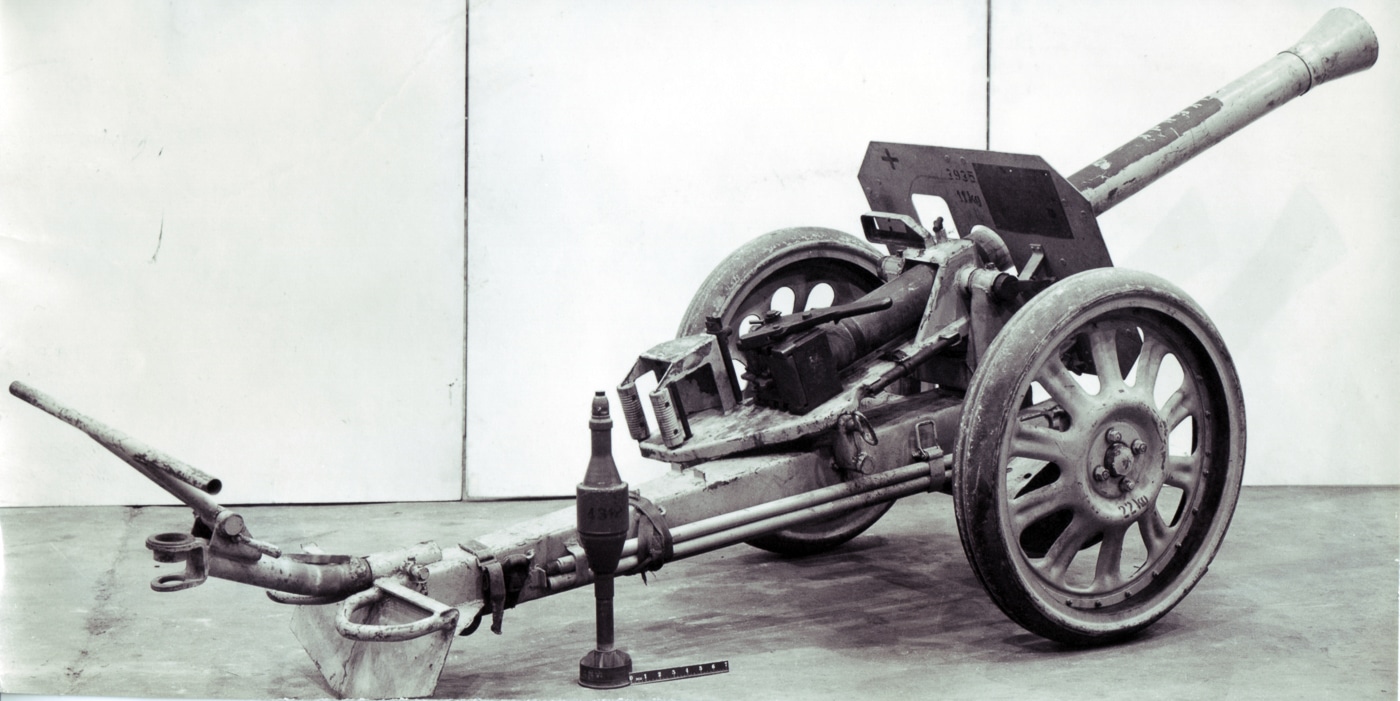

At first glance, the 8.8 cm Raketenwerfer 43 Püppchen (“Dolly”) appears to be a tiny artillery piece. In fact, it is a development of the Panzerschreck—intended to give the anti-tank rocket launcher greater range and accuracy. The 315-pound carriage-mounted weapon used a new rocket, the RPGr4312, which replaced the Panzerschreck electrical ignition system with a percussion cap igniter.
American soldiers in World War II uniforms gather around a captured 8.8cm Raketenwerfer 43 Püppchen anti-tank rocket launcher on display somewhere in France. US forces captured German rocket weapons in Europe. Allied troops examined enemy anti-tank launchers. The Püppchen was a prized intelligence find. American soldiers encountered German rocket technology. The Raketenwerfer 43 interested US ordnance experts. GIs inspected captured Wehrmacht equipment. Allied intelligence studied German hollow charge weapons. The 88mm rocket launcher was displayed for troops.
American soldiers examine a captured 8.8cm Raketenwerfer 43 Püppchen somewhere in France. Image: NARA
The Püppchen was loaded through a sliding breechblock, and on firing the exhaust gases were contained within like a normal artillery piece. The barrel pivoted on a pintle which allowed for simple aiming and easy target acquisition. The carriage wheels could be removed to lower the profile, and skis could be added for transport across snow. Firing instructions were printed directly onto the gun shield.

The Püppchen offered more stability as a firing platform than the Panzerschreck, increasing accuracy and providing an effective range of approximately 500 meters (and a max range of 750 meters). However, there was nothing that could be done about the dramatic firing signature of the rocket launcher. It was unlikely that a Püppchen crew could get off more than a couple of shots before they were observed, and targeted or overrun.

“The Püppchen, a carriage-mounted rocket launcher with breechblock also fires the 88-mm rocket. Although the Püppchen has wheels, the gun can be fired from little sleighs to achieve a very low silhouette. While the Püppchen has a range of 770 yards, it is very lightly built and is likely to smash up when towed by motor vehicles.”

“This weapon is a closed breech rocket launcher which fires a rocket projectile. It is transported on a two-wheeled carriage and may be fired from the carriage or from firing segments to lower the silhouette. If necessary, it may be readily disassembled into seven loads for transport. A cone-shaped gas deflector is fitted over but does not protrude beyond the muzzle. The piece is aimed by grasping two handles fitted to the left rear of the cradle and aligning the open sights on the target. The rear sight is adjustable from 180 to 700 meters. The launcher fires from a closed breech which is operated by a handle on top of the breech ring. Opening of the breech cocks the hammer which is held in firing position by a sear. When the projectile has been inserted and the breech closed, a squeeze of the right handle depresses the sear, releasing the hammer. A safety device fitted to the left of the firing pin in the center of the breechblock must be turned to “F” position before the launcher can be fired. An additional safety feature prevents the hammer from striking the firing pin unless the breech is fully closed. The small shock of recoil developed by the rocket gases against the closed breech is transmitted directly to the spade. Ammunition used with the rocket launcher is a modified version of the 8.8 cm rocket projectile, having a percussion primer instead of the electric type. The rocket is fitted with a base plate with a protruding rim to seat the round in the tube. The base plate and primer are the only parts of the round which are extracted after firing.”
