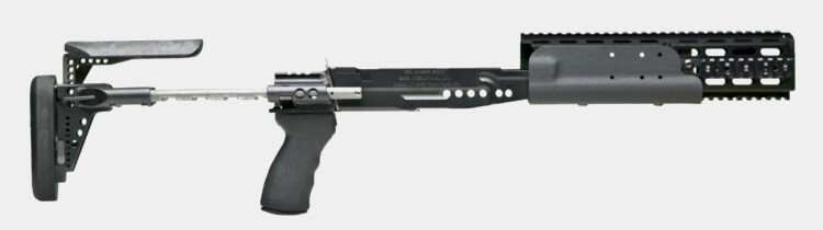

A week later, it showed up on my doorstep. I was like a kid at Christmas. The one I was able to purchase was the M14ALCS variant of the EBR, which features a telescoping stock with an adjustable cheek rest. It has 5 points of adjustment in the stock and 9 points of adjustment for the check rest, so you can fit it exactly to your needs. The result is a stock that makes the rifle very compact, but also fully capable of being used with an optic.
Sage EBR stock
The chassis has a telescoping stock and an adjustable cheek rest to give you a perfect fit behind the trigger.
The pistol grip of the stock is an AR-pattern Ergo Grip, and is interchangeable if you so desire. The forend of the chassis system features Picatinny forward mounting surfaces of 3 o’clock, 9 o’clock and 6 o’clock, and a 12 o’clock one-piece machined top with integral rail. Additionally, the chassis system comes with a formed Kydex handgrip with a built in palmswell. The detachable Kydex hand grip minimizes heat transfer generated by high firing rates.

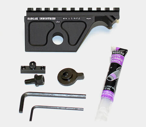

Sadlak scope mount for M1A
The author mounted a variable power EOTech Vudu scope on a Sadlak Manufacturing scope mount designed for use with the Sage EBR.
The weight of the EBR-equipped M1A was 11.24 lbs., which is a heavier configuration compared against the standard M1A SOCOM weight of 9 lbs., 2 oz. However, with it you are getting a lot of additionally capabilities and the ability to mount a good amount of accessories.
Like any good EBR build, it needed a beautiful optic with a proper height and eye relief. As you well know, this requires an optic mount for the M1A rifles. In my opinion, Sadlak Industries makes some of the finest mounts available for the M1A in the Sage stock, with an aluminum mount specifically designed for use with the Sage Chassis. They also cleverly machine out a channel through the picatinny rail so that you can still use your iron sights. The mount came with extensive instructions that were easy to follow, and it provides an extremely strong and reliable base for scope.

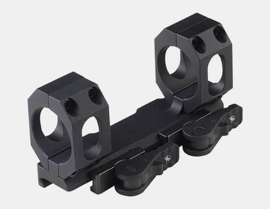

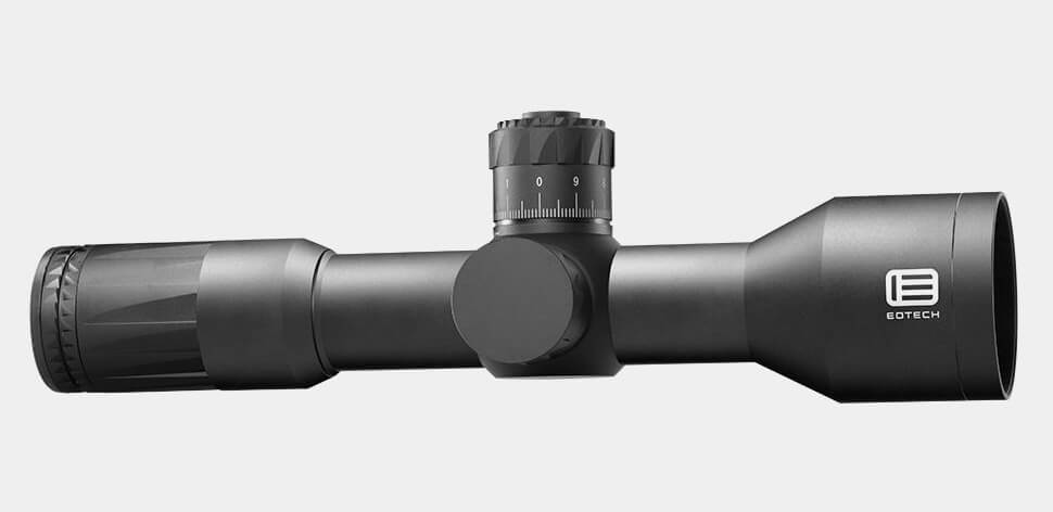

The scope I chose for this build is an EOTech Vudu 5-25×50 with an American Defense Manufacturing Recon low mount. The scope is very robust, tracks perfectly and has a great reticle. In the future, I may switch the scope to an EOTech Vudu 2.5-10×44 and get an even lower cheekweld.
Scope mounted on M1A SOCOM 16
The author fitted a EOTech Vudu 5-25×50 scope to the M1A for precise, long range shooting.

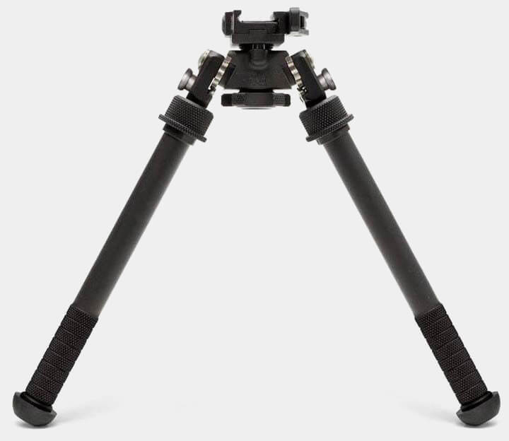

With a high-powered rifle and scope, a bipod is a must. I chose my go-to Atlas Bipod for its lightweight and slim design, while also being one of the strongest designs on the market.
