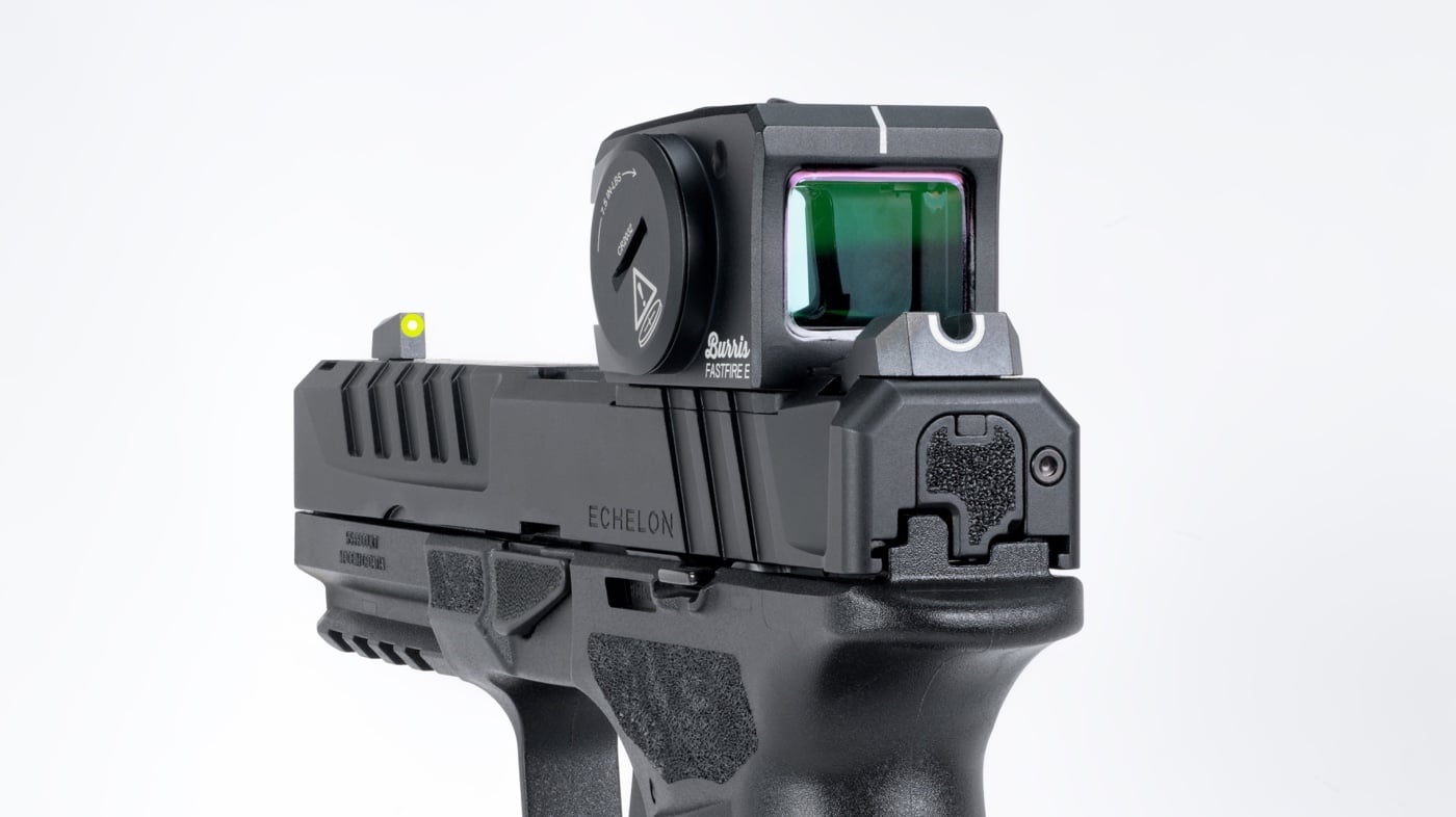

Photo shows a Burris FastFire E red dot sight securely mounted on the slide of a Springfield Echelon pistol. The optic’s fully enclosed design and robust 7075 aluminum housing are visible, emphasizing its durability. The fit appears precise, with no overhang or alignment issues, demonstrating compatibility with duty-style handguns. The Echelon’s iron sights are visible and co-witness through the optic’s window, supporting backup sight use. This image highlights the optic’s ruggedness and professional appearance. The background is neutral, keeping the focus on the pistol and mounted optic. The image would be useful for readers seeking information on mounting, construction, and duty use in a Burris FastFire E review.
The author found that the FastFire E was ruggedly constructed and fit perfectly on his duty-oriented Echelon pistol.
