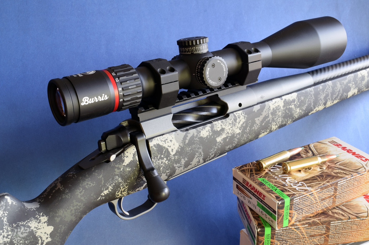

Burris Fullfield scope on Springfield Armory rifle
The new 6-24×50 Burris Fullfield performed well with the accurate Springfield Model 2020 Boundary rifle in .308.

I prefer lighter sights, even with high magnification. So, the new Burris Fullfield 6-24×50 caught my eye. At under 19 ounces, it weighs less than many mid-power scopes. It’s the most powerful of fifth-generation Fullfields, which include a 2-8×35, a 2.5-10×42, a 3-12×42, a 3-12×56 and a 4-16×50. Like the 3-12×56, the 6-24×50 has a 30mm tube. The others are an inch in diameter.
Burris’ fifth-generation Fullfield series comprises six variable scopes, with this 6-24×50 being the most powerful.
Given its modest heft but 24x top end, I wanted to pair this new scope with a lightweight but very accurate rifle. A Springfield Armory “Boundary” bolt-action in my rack was the perfect match. This .308 had proven capable of nipping one-hole knots with 165-grain Sierra Tipped GameKings in new Barnes “Harvest Collection” factory loads. Cinching the 6-24×50 Fullfield onto the Boundary’s rail in medium rings left plenty of space between the objective bell and the rifle’s thick carbon-fiber barrel.

While a 50mm front lens is arguably as small as is practical in a hunting scope with a top end of 20x or 24x, this fifth-generation Burris Fullfield is otherwise trim. Its one-piece 30mm aluminum tube has a compact turret with low exposed dials, not long stems protruding like triggers on harbor mines. The left-side focus/parallax dial is easy to grasp but no bigger than need be. The eyepiece is delightfully modest — 1.6 inches in diameter and 3.2 inches long, or just .1 inch longer than that of my 2-7×35 Burris.
