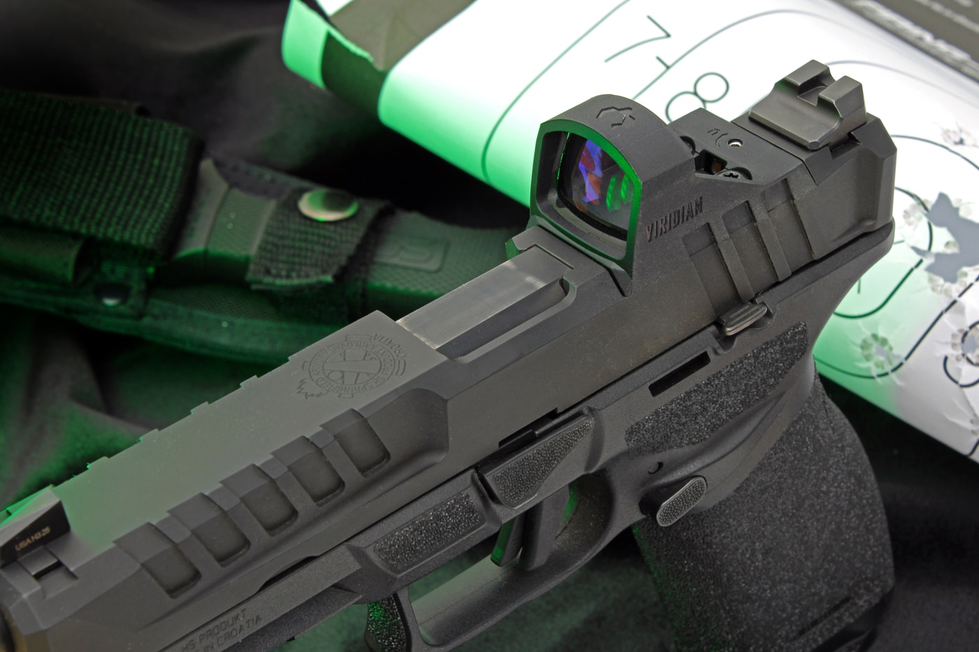

You have a well-made, high-quality defensive handgun. You have bought the best defensive rounds available and made sure they run in your pistol. You have a sound EDC rig that allows you to quickly and safely present your firearm, and you have trained to do it effectively. You are set, right? However, you simply cannot seem to consistently hit with the groups you think you should.
Viridian optic on Echelon
Blaming the sights is rarely the path to improved shooting. Yes, ensure your sights or optic are properly dialed in. After that, work on your weaknesses to improve accuracy.
