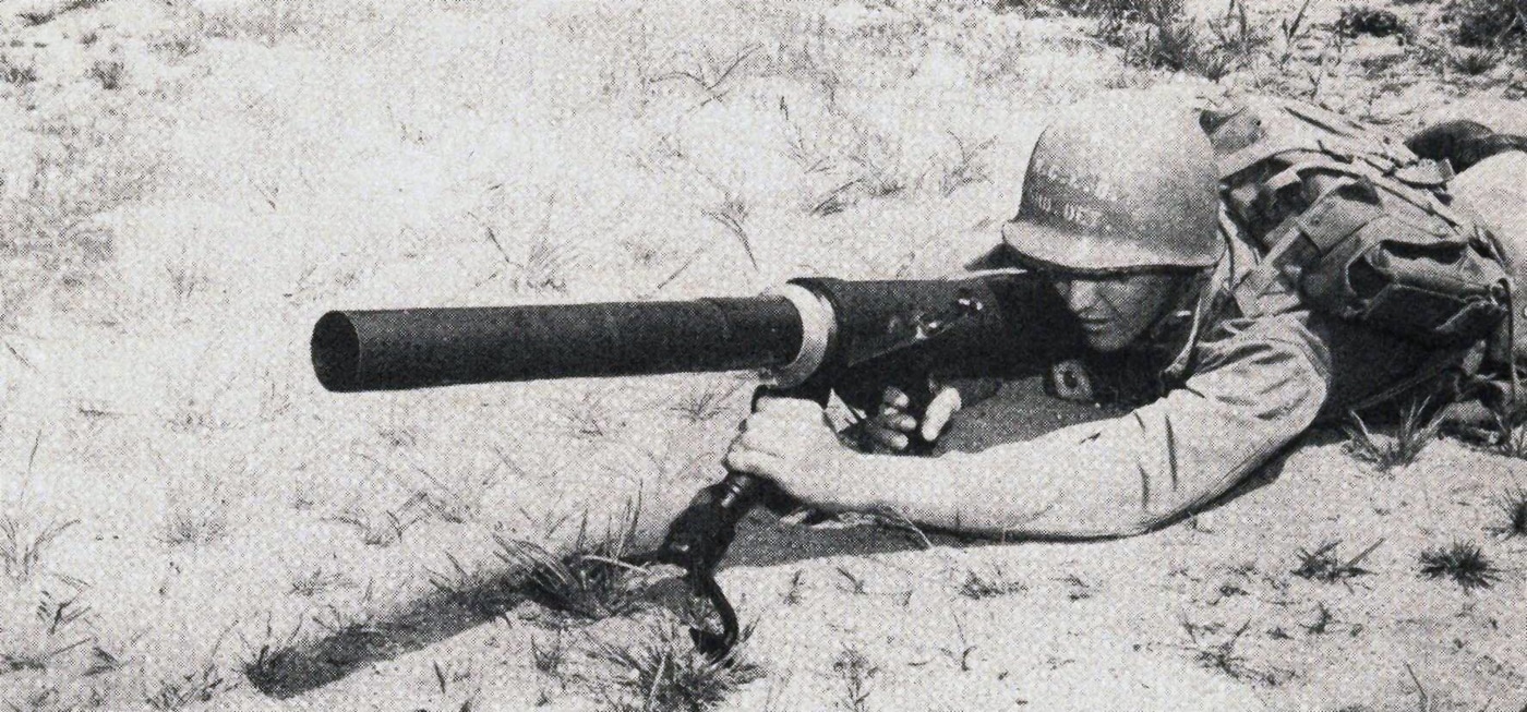

Training to use the new device by a gunner and assistant was fairly simple. Cock the weapon by pulling back firmly on the barrel sleeve until you hear a distinct click. Take your basic 60mm mortar round and strip away all the propellant increments. Then dump the round down the tube, which is elevated to insure the shell drops all the way to the bottom of the tube where it’s cartridge is positioned to be struck by the firing pin.
US Marine working with Garrett 60mm shoulder fired mortar
A U.S. Marine trains with the 60mm Garrett shoulder fired mortar that could provide direct fire support. Image: U.S. Bureau of Ordnance
Take up a solid prone position, tuck that shoulder pad in tight, acquire a good sight picture and squeeze the trigger. There was no mention of saying a quick prayer prior to launch, but I’m betting most gunners tasked with firing the Garrett included it in their routine.
The U.S. Marine Corps’ first (and likely last) employment of the Garrett 60mm shoulder-fired mortar was on Peleliu in September 1944. After-action reports were less than complimentary. Here’s what the 1st Marine Division annex to the weapons used on Peleliu had to say about the Garrett:
Some of its parts proved not rugged enough for sustained use and had to be replaced nearly as often as the poor devils who were obliged to fire the contraption from their shoulders. Essentially its functions duplicated those of the bazooka. (However) it came to be considered less practical all around than the weapon it had been designed to replace. As presently constructed, they (shoulder mortars) are too heavy and certain parts are too weak. After firing two to four rounds, it is necessary to replace the gunner. Units feel that the shoulder mortar as now constructed is not of sufficient value to include it in the authorized weapons.
