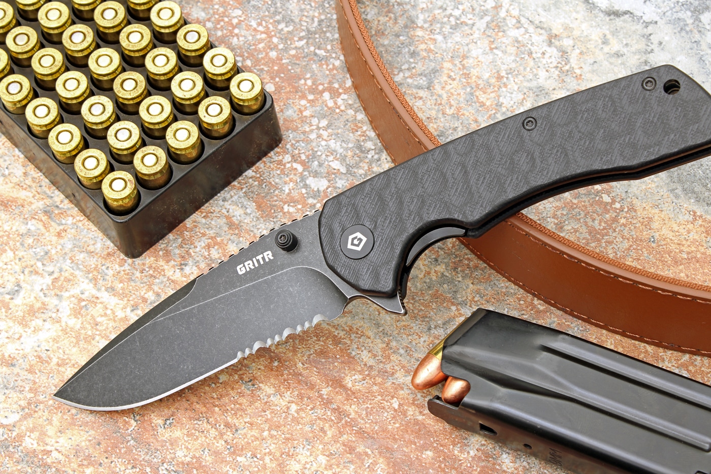

The Features
Priced at $44.99, the GRITR Stealth mates 4.7” of handle with a 3.5” blade for a total unfolded length of 8.2”. Though it’s a hand-filling and full-sized pocketknife, skeletonized stainless steel liners and G10 scales keep the weight down to a light 4.2 ounces. The knife features a pass-through construction, with spacers separating the two halves; if grit gets into the action, this makes it really easy to blow or hose things out.
Stealth knife blade length and type
Blade length matters more than you’d think. The GRITR Stealth’s edge length puts it firmly in medium folder territory: big enough to handle serious tasks, yet compact enough to carry in your pocket.
The knife deploys either via ambidextrous thumb studs or by the generous flipper tab, and the blade rides on ceramic ball bearings, so deployment is extremely smooth and fast. Lockup is accomplished via a steel liner, and the knife features a deep carry clip, making for a very unassuming and discrete profile in the pocket. The clip is also free of any branding or lettering, which I appreciated. “Stealth” indeed.
Onto the blade details. The GRITR Stealth is partially serrated; the serrations are chisel-ground to give the base of the blade a little more bite when sawing through fibrous materials. Additionally, the blade is saber-ground with a drop-point design, featuring prominent jimping along the spine and a swedge as it narrows to its terminal point.
folding knife locking type
The GRITR Stealth uses a liner lock system that consistently hits the halfway point on the tang, exactly what you want to see in a well-made folder.
The blade material is D2. If you’re not familiar with the compound, it’s an extremely hard-wearing tool steel with excellent edge retention—you can find steels that are more abrasion-resistant, but you really need to start shelling out money to get better cutting performance. The only real knock to D2 is that it’s not a true “stainless” compound and is more prone to rusting. That said, the GRITR Stealth features a coated finish on the blade to keep corrosion in check.

First, this feature set makes perfect sense for a single folding knife offered by the brand. This is a “jack of all trades” tool if there ever was one. With the drop point and swedge construction, the knife has strength at the tip for piercing material, but the blade thins out well enough to make it a good slicer—and both of the Stealths sent to me for review were shaving sharp right out of the gate. The jimping allows users to really bear down on this to cut or saw through difficult material, but there’s enough point and belly here to perform more precise cutting tasks.

There are bigger knives than the GRITR Stealth, and smaller ones, too—that 3.5” blade length places this very solidly in “medium” territory, as far as feel goes. Similarly, there are beefier folders with even more reinforcement near the tip, knives with extremely thin blades that are better for slicing, and wharncliffe style blades that particularly excel when making draw cuts. The GRITR Stealth is not what I would reach for to stab through an oil drum or dig out a splinter. However, it is designed in such a way to make it a solid choice for about 95% of the tasks a person needs a knife for.
Let’s also return to the serrations. Turn over your nearest rock, and you’ll find a “knife guy” who will vociferously announce he’d never buy a partially serrated knife. The two most usual criticisms are that a person usually isn’t doing much rope cutting on the regular, and that serrations are hard to sharpen. Here, however, I think the partially serrated edge makes a great deal of sense. First, your Average Joe probably will cut through something fibrous several times a year and probably would appreciate the functionality. Second, and to paraphrase knife expert Lynn C. Thompson, serrations do seem to always have “one more cut in them” even when dulled. It’s hard to make them razor sharp, but they remain “work sharp” for a very long time.
