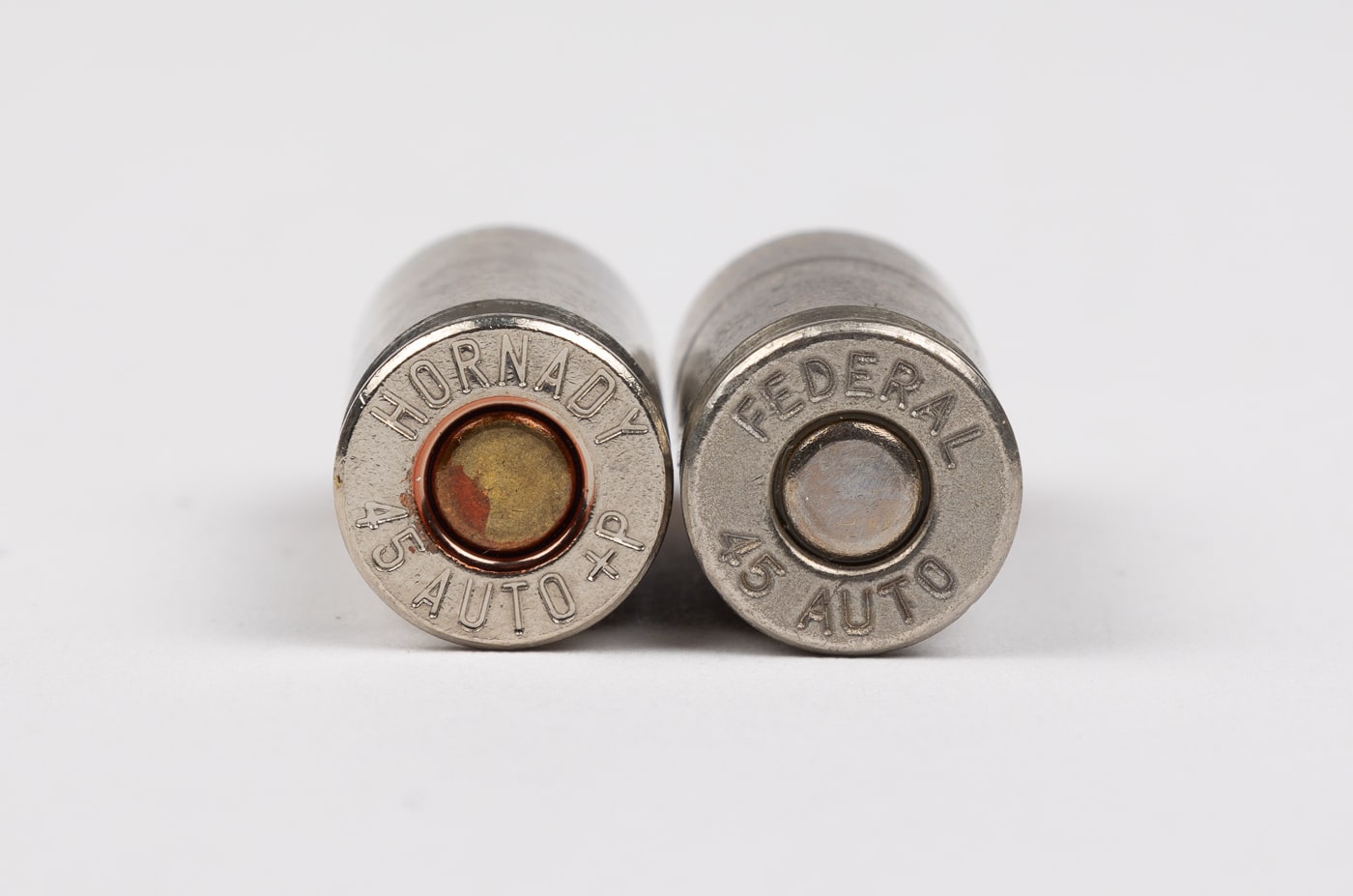

Photograph featuring two ammunition cartridges showing headstamp markings with one displaying plus P overpressure designation and one showing standard pressure specifications. Cartridge headstamps contain crucial safety information about ammunition pressure levels. Plus P ammunition can be identified by specific markings stamped on the cartridge base. Standard pressure loads show different headstamp information without overpressure ratings. Firearm safety requires matching ammunition pressure specifications to gun manufacturer ratings. The headstamp comparison illustrates differences between higher pressure plus P loads and regular pressure ammunition. Shooters must verify cartridge markings before using overpressure ammunition in any firearm. Understanding these stamped designations prevents using plus P rounds in guns not designed for increased pressure loads.
Standard pressure and +P cartridges look nearly identical from the outside. The headstamp is where manufacturers stamp the pressure designation you need to know.
Check your firearm’s manual or the barrel markings. If it says “+P” somewhere on the gun or in the documentation, you’re good to go. If the manual warns against using +P, don’t use it. Simple as that.
