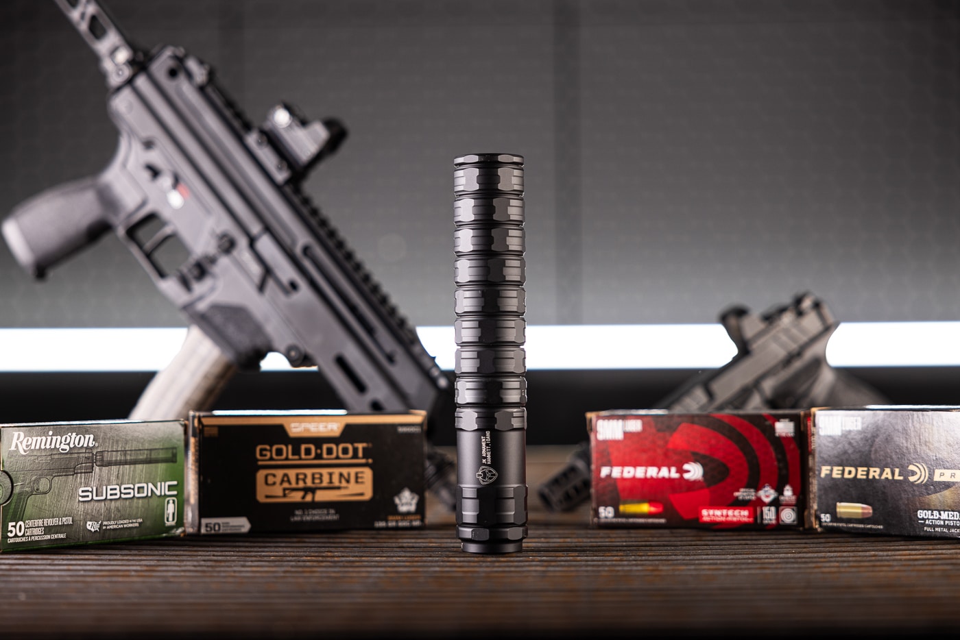

An authentic product photograph showing the JK Armament 155 RPX suppressor reviewed by the author positioned with the Federal, Remington, and Speer ammunition used during range testing. The JK Armament 155 RPX 9mm suppressor review prioritized genuine evaluation. This silencer fired hundreds of rounds during testing. Ammunition selection impacts suppressor performance significantly. The RPX features Cerakote and hard-anodized finish protection. Heavier bullets optimize sound reduction when suppressed. Real gear reviews provide trustworthy buyer information. The modular design allows length and weight customization. Shooters benefit from honest hands-on suppressor evaluations.
The JK Armament 155 RPX 9mm suppressor shown here with the ammunition used throughout this hands-on review.
