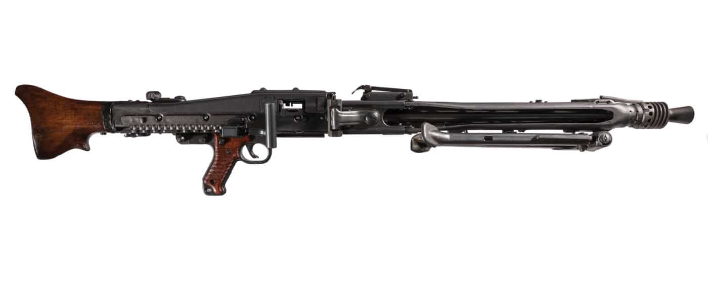

MG 42 machine gun displayed on a plain surface with its bipod extended. This is a German belt-fed general-purpose machine gun from World War II, sometimes called Hitler’s Zipper or Hitler’s Buzzsaw. The photo clearly shows the gun’s stamped steel receiver, barrel, and folding bipod. No accessories or extra gear are present. The weapon looks to be in good condition, with all main components visible, including the barrel shroud, pistol grip, and buttstock.
The MG 42 stands out for its durability and influence on postwar machine gun designs. Its utilitarian stamped steel construction allowed for faster and cheaper manufacturing. Image: Rock Island Auctions
