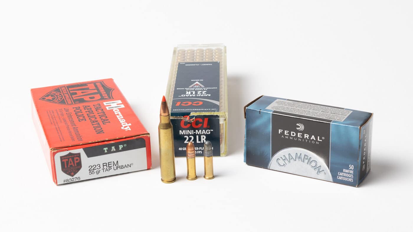

comparing centerfire and rimfire 22 caliber cartridges
Both .22 LR (center and right) and .223 Remington (left) use projectiles of the same diameter. However, the power difference between the two is vast.
