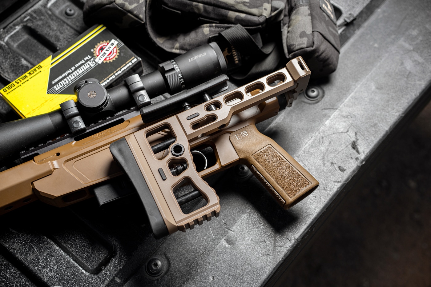

The SAS is modular, skeletonized, lightweight and foldable — all things that support an all-metal, short and agile bolt gun. I decided it would be the perfect match for my 16” 6.5 Creedmoor Model 2020 Heatseeker. My purpose all along for the Springfield Heatseeker was to make something super compact, suppressed and lightweight for a pack or my truck. It is offered in versions that attached to AR-style buffer tubes or Picatinny rail.

The subject of the review is the Samson SAS, an aftermarket folding stock that swaps onto AR-style buffer tubes or a Picatinny rail.

The SAS stock from Samson features a spring-loaded button for easy, four-position height adjustments on the cheek riser. These adjustments come out to 0.7”. For the length of pull, there’s another spring-loaded button with five positions of adjustment at 1.25”.
buttpad on Samson SAS stock
That durable rubber pad on the tail of the SAS folder isn’t just there for looks. It soaks up recoil and keeps the shooter comfortable through a long string of fire.
Other features of the stock include ambi steel QD points for running a sling, which works perfect for my compact run-and-gun approach on this Heatseeker (which also has QD points). The folding mechanism can be set up for left or right folding, and it’s also designed to not interrupt the trigger guard when folded. The stock has a durable rubber pad affixed to the back providing maximum comfort under recoil.
The stock is made from durable yet lightweight 6061-T6 aluminum and is skeletonized to reduce weight (and just simply look rad). The finish on the SAS stock is MIL-A-8625 type III class 2 anodizing. The SAS stock is 10-11” long, 5” high, and 1.25” wide weight 19.68 oz.
