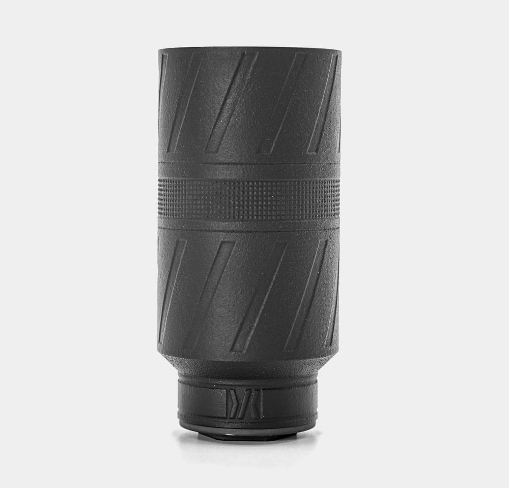

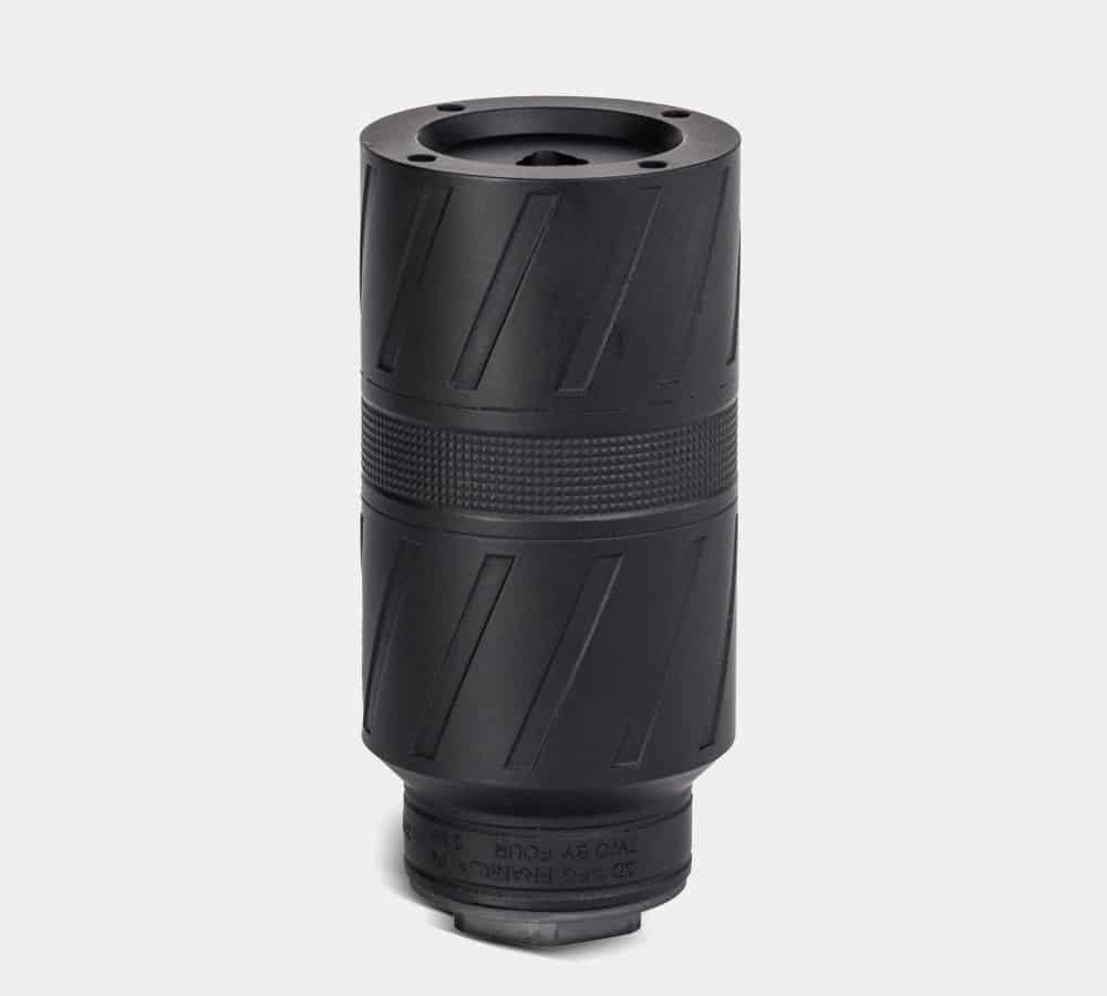

The company’s solution was visionary. The Speed K is entirely made from Inconel through the additive process of 3D printing. The use of Inconel 718 alloy is not new to suppressor design, but it is still somewhat exotic. The material is similar in weight and strength to stainless steel, but it is renowned for its heat resistance. In fact, Inconel is probably best known for its use on spacecraft engines because it can withstand the blast from rocket boosters. Using a 3D printer, complex internals designs become easy to achieve as the material is simply added layer by layer, with no welds required.
In addition to the Inconel version I did all my testing with, which weighs in at 14.1 oz. and has an MSRP of $1,199, Silencer Central also offers a Speed K constructed of titanium. That version weighs in at 8.6 oz. and has an MSRP of $1,399. Both feature a black Cerakote finish.
Hands-On
The result is an absolute unit. The Speed K is a monolithic, mono-metal suppressor that is both surprisingly short and deceptively hefty. With a direct thread adapter installed, the can is about 4.25” tall and weighs just more than a pound in the Inconel variant I was testing. Its body diameter is right about 2”. In the hand, it reminds me of the size and weight of a smoke grenade.
Unlike Silencer Central’s multi-caliber offerings, the Speed K is intended to be a dedicated 5.56/.223 muzzle device. However, it is compatible with a wide range of rifle makes and models because it mounts using industry-standard HUB-pattern adapters. The can has an integral collar below the main body, the inside of which is threaded 1.375×24 to accept thread-specific muzzle adaptors. Silencer Central includes one with the purchase of the Speed K and others can be added separately. There are eight thread options to choose from but, given the chambering, 1/2×28 is going to be the most common selection. The mounting adapters are made of titanium.
