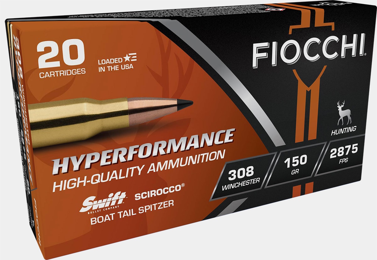

The rifle was delightfully un-fussy about the loads it gobbled, with us trying a broad range of 16 loadings ranging from 110 grains up to 185 grains. Over the course of our shooting, the rifle punched near-minute five-shot groups at either end of the 110- to-185-grain bullet-weight spectrum.
Springfield Boundary ammunition test on shooting range Fiocchi ammo load
Springfield’s Boundary bolt-action hunting rifle drilled this tight group with this Fiocchi load that used middle-weight Swift Scirocco bullets.
All told, we ended up with three of the best loads hovering at half an inch with three-shot groups – well under the .75 MOA accuracy guarantee. This is excellent accuracy for a 6½-lb. sporter fed a variety of commercial loads!

Fiocchi 150-gr. Swift Scirocco2,788 fps0.6″

Group size is measured in inches and is made up of three-shot groups and fired at 100 yards. Velocity in feet per second and is the average of three rounds at 10 ft. fired across an Oehler 35 chronograph.
