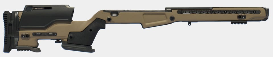

Archangel Precision Adjustable Stock
The M1A barreled receiver drops into the Archangel polymer stock, so it is easy to assemble. Don’t miss Yamil Sued’s video on the Archangel stock.
Archangel Stock for Springfield Armory M1A rifle line
One of the most popular aftermarket stocks for the M1A is the Archangel stock.
The design also provides little pressure to the barreled action, so accuracy is not adversely affected. I like the cheek-riser, which employs a click-adjustable thumbwheel with ½” increments. The length of pull is also adjustable with a click-adjustable thumbwheel. You can adjust LOP from 13.5” to 14.8”, which is great, especially when you have on a heavy coat or gear with shoulder straps.
Right side view of the Archangel M1A stock
The Archangel stock is easy to install and offers a range of additional features for your M1A rifle.
The buttpad is contoured and made of soft rubber to help slurp up recoil. The forend has an extended Picatinny rail mount on the underside so you can easily mount a bipod. The forend is grooved so the rifle feels less chunky, and you use the grooves to better grip the forend. It also has four internal steel inserts for ball-lock/push-button quick detach sling swivels. Plus, there is a storage compartment in the pistol grip. I like the angle of the pistol grip and the palm swells. When shooting prone, this pistol grip is very comfortable.
