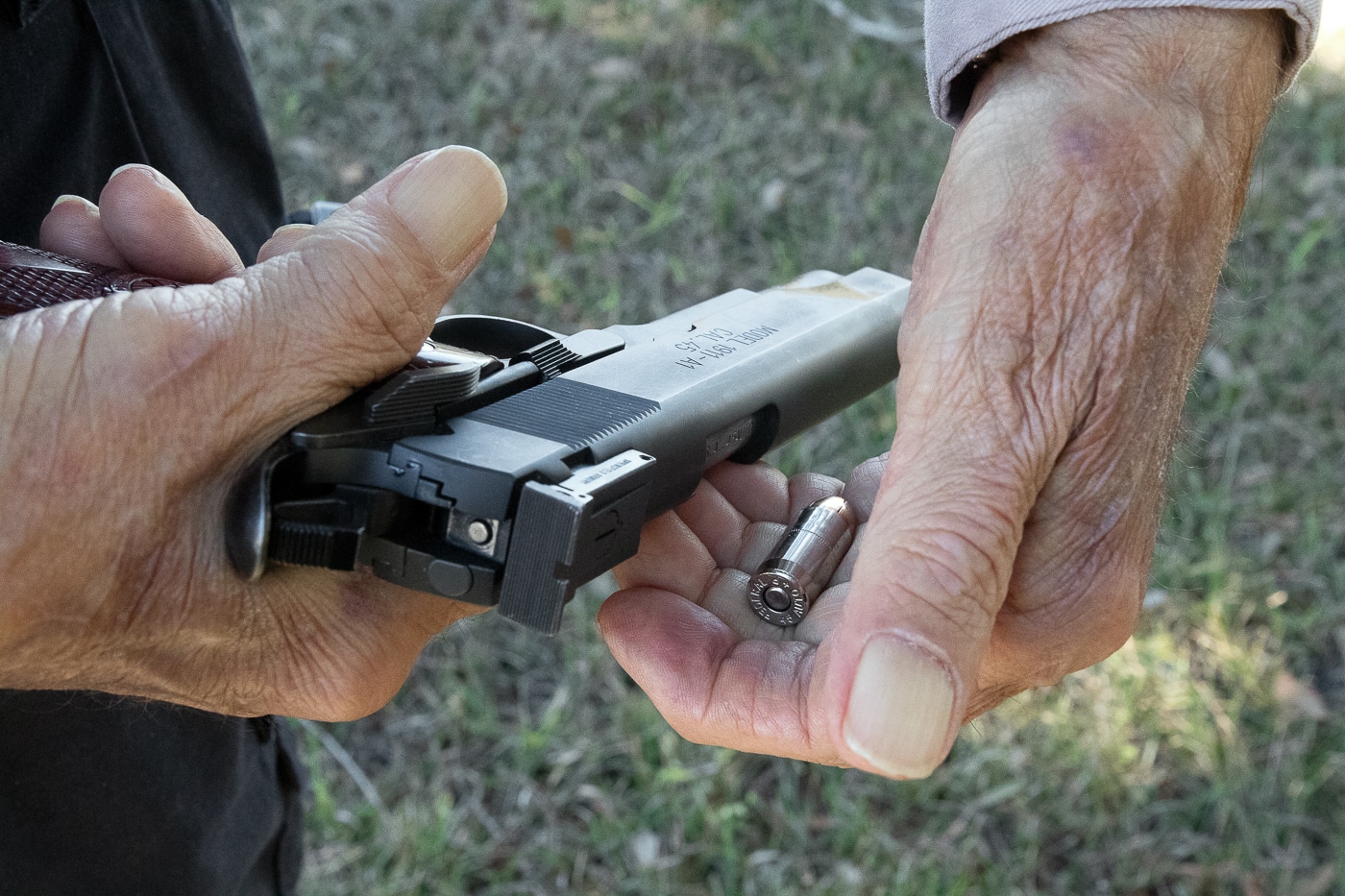

ejecting a cartridge into your hand is not completely safe
Ejecting a cartridge into your hand, as the author illustrates here, is not a sound move. What if you were to have an open-chamber detonation? Image: Gail Pepin
When Unloading
Some time early in the epoch of the 1911, folks figured out that they could unload by removing the magazine and then, with the palm of their free hand over the ejection port, rack the slide and eject the chambered cartridge into their hand.
In the early days of 1911’s with short ejectors, one could get away with that. Today, most autopistols have longer ejectors. If the slide sticks and the shooter pulls harder and achieves a sudden, sharp rearward movement, there is a chance the primer could be driven into that long ejector and cause an open-chamber detonation. This would not be good.
The brass casing is no longer surrounded by ordnance steel, but rather by the palm of your hand. If everything breaks wrong way, it turns into a miniature grenade that could drive brass shrapnel into the nerves of the palm of the hand. Just eject the darn thing to the floor or the ground. Open chamber detonations are rare, but they can happen. It’s not worth the risk.
There are still some schools that teach their students to unload that way … and there are some schools and police academies that forbid it. This writer is in the latter camp. Saying, “I’ve always done it this way and never had an accident” is like saying “I never wear a seatbelt and never had an auto accident.” The point is, the accident you haven’t had yet is the reason you wear the seatbelt just in case. Same in this regard.
