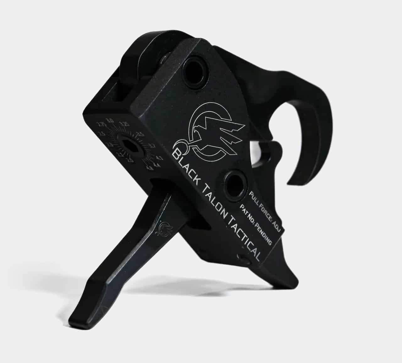

Black Talon Tactical adjustable drop in trigger review for AR-15-style rifle
The Black Talon Tactical adjustable trigger for AR-15-style rifles is a single-stage design that is easy to install.

However, before you install a Black Talon adjustable trigger, you need to use the provided Allen key and set your trigger pull weight. On the housing, you will find an adjustment screw that allows you to set your pull weight from 2 lbs. up to 5 lbs. Adjustments are guaranteed to be within 1 oz. pull force of whichever weight you choose. You can easily pick your perfect weight using the calibrated scale clearly laser-etched on the trigger housing. It is that easy to customize your trigger.

The trigger comes with some anti-walk trigger pins and a set of 2mm Allen wrenches needed to tighten them down. Unfortunately, the pins I got have a nice set of black screws on one side but some silver-colored screws on the other side. I would like to see a nice set of all-black hardware. Although, this is not a deal breaker since you could just use your own pins.
Black Talon Tactical adjustable trigger review feel
The Black Talon Tactical trigger reviewed by the author uses the company’s Improved Finger Position (IFP) bow. The author liked the feel of it.
The trigger also features a set of snug-down screws on the back of the housing by the safety selector. These must be snugged down before using the new trigger because of the super high tolerances on this trigger. A wrench is provided for those screws as well.
Black Talon features three different trigger shoe options on its website for this trigger system. A curved bow, a straight bow, and the one we are talking about here — a new design they call IFP, or improved finger position bow.
This is the trigger I chose to test because it is a bit unique in design. The shoe almost forces your finger to fall into an optimized shooting position every single time, which creates a more consistent trigger pull in my opinion. I personally really like the feel of it. The company took the stance of Henry Ford when they designed all the components and coated them. You can choose any color trigger you want as long as it’s black.
