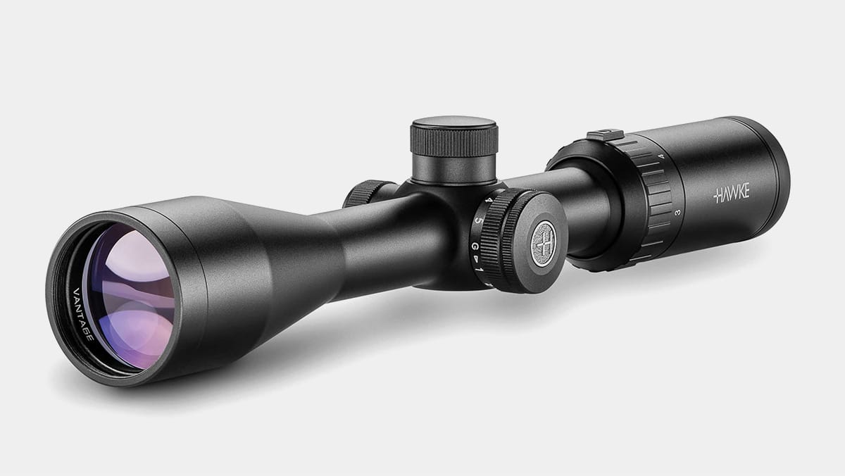

The Hawke Vantage IR scope is an affordable, variable-power optic for .22 LR rifles. It performs well when plinking and whacking varmints.
Pairing the right scope with the right rifle shouldn’t be complicated, nor should you necessarily need to pay as much for the scope as you did the rifle. I recently set out to do just that with my Model 2020 Rimfire Target rifle from Springfield Armory, and what I decided upon was the Hawke Vantage IR 3-9x40mm scope. It offers a lot of performance at an affordable price, especially with the Rimfire .22 LR HV reticle that makes taking shots from 50 yards to 200 yards a slam dunk.

I can honestly say that the quality of the Hawke scope is neither cheap or inferior. It’s quite the opposite. The Vantage’s reticle choices range from ones designed for rimfire calibers and shotgun slugs to AR platform calibers and centerfire bolt actions. The Vantage IR is a subset of the series with scopes equipped with illuminated reticles, hence the IR suffix.

The 3-9×40 scope wears a matte black finish, and the controls are solid. The turrets are capped and adjustment indicators are basic — but simple and easy to use. The direction is indicated and the clicks are precise. Each click is .25 MOA, and there is 100 MOA range of movement in both windage and elevation. The parallax adjustment shares space with the reticle illumination knob.
Here we see the author reviewing the Hawke Vantage IR 3-9x scope on an outdoor shooting range.
The Hawke Vantage IR 3-9x scope has capped turrets that help ensure that you don’t lose zero if the scope is bumped on the range or in the field.
The reticle has five brightness settings and two color choices—red and green. I did note that the parallax knob takes some effort to turn, while the illumination levels and colors are easily adjusted. The eyepiece has a rubber edge that makes focusing the reticle easy. The power ring is ribbed and offers adequate texture when zooming in and out, and it does take effort to rotate, but I was able to adjust the power range without disrupting my sight picture while in the prone position or sitting at a bench.
