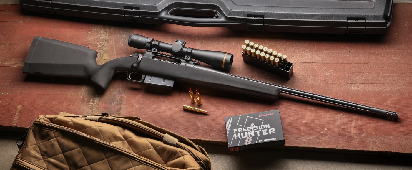

Springfield Armory Model 2020 Waypoint with SG-100 Cerakote finish in 7mm PRC
Springfield Armory’s Model 2020 Waypoint now comes in an understated black finish, with an H-164 Cerakote barreled action riding in an AG Composites carbon fiber stock. The stock itself features an SG-100 “Sure Grip” coating. Image: Carson McDaniel

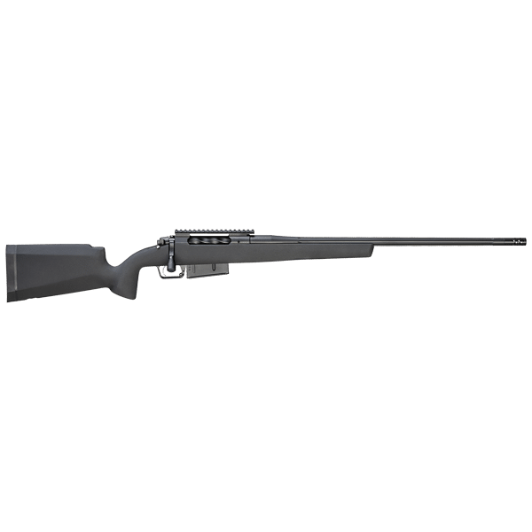

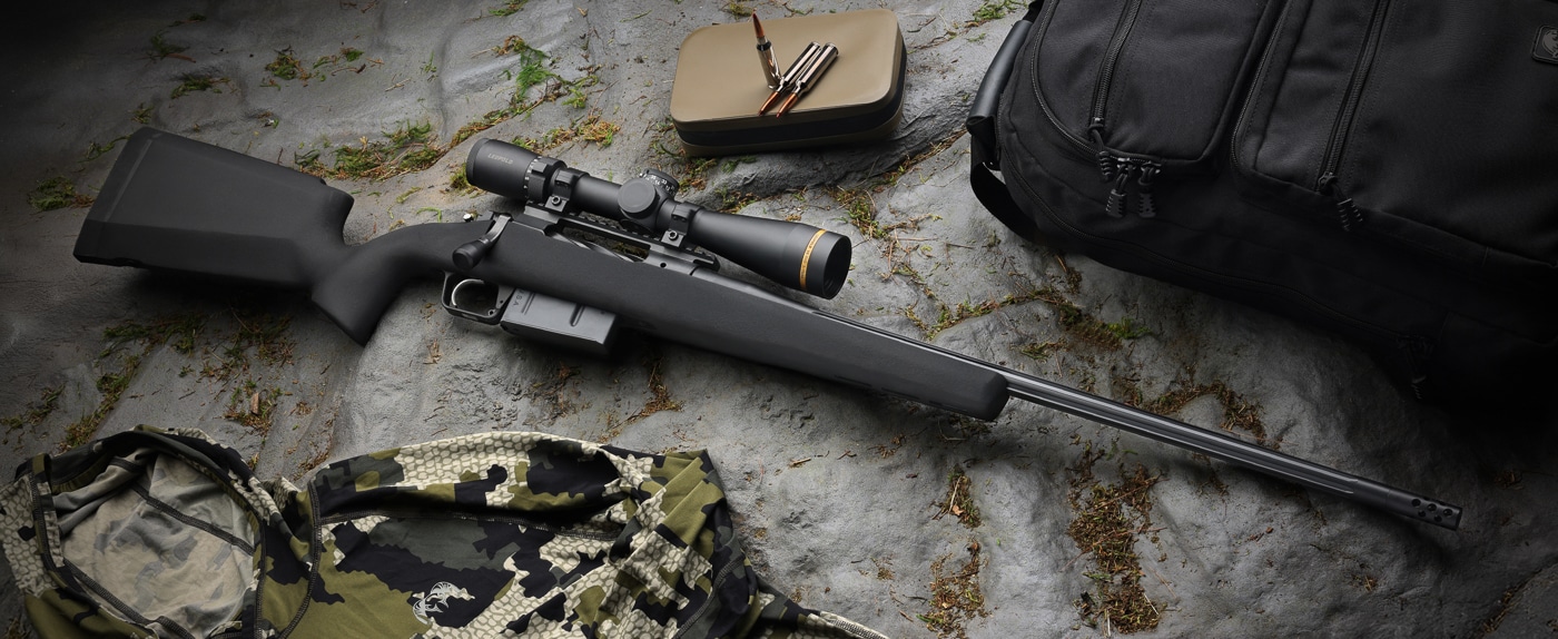

Springfield Armory Model 2020 Waypoint with SG-100 Cerakote finish in 300 Win Mag
The long-action .300 Win. Mag. version carries a 24″ fluted stainless barrel capped with an SA Radial Muzzle Brake. Like its stablemates, it wears the specialized SG-100 coating on the stock. Image: Carson McDaniel

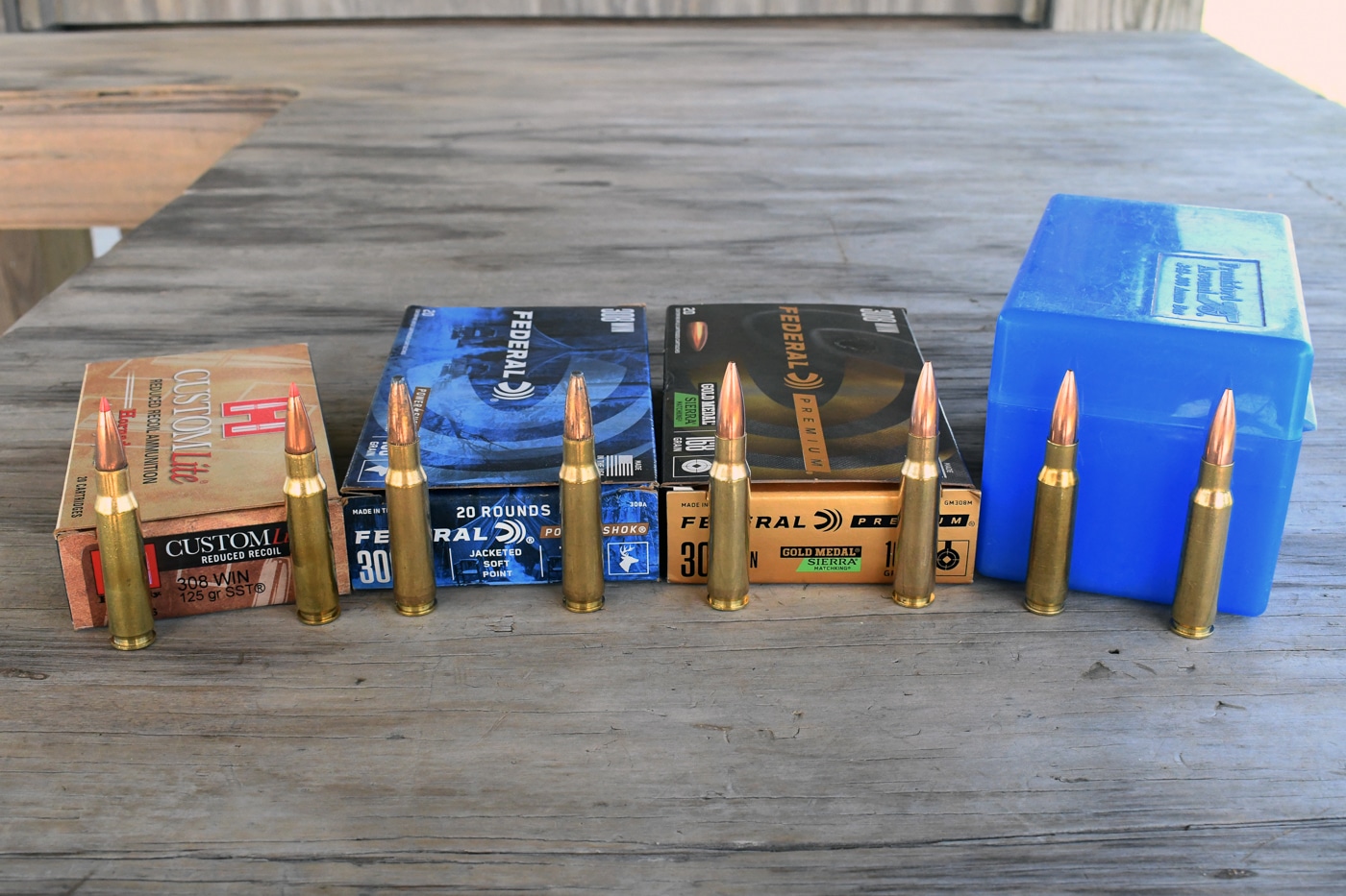

lineup of 308 Win ammo the author used to test the Springfield Armory Model 2020 Waypoint with SG-100 Cerakote finish
The author tested the Model 2020 Waypoint with SG-100 Cerakote finish rifle using a variety of factory ammo and handloads with bullets ranging from 125 to 168 grains.

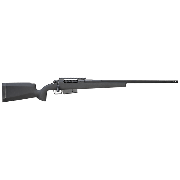

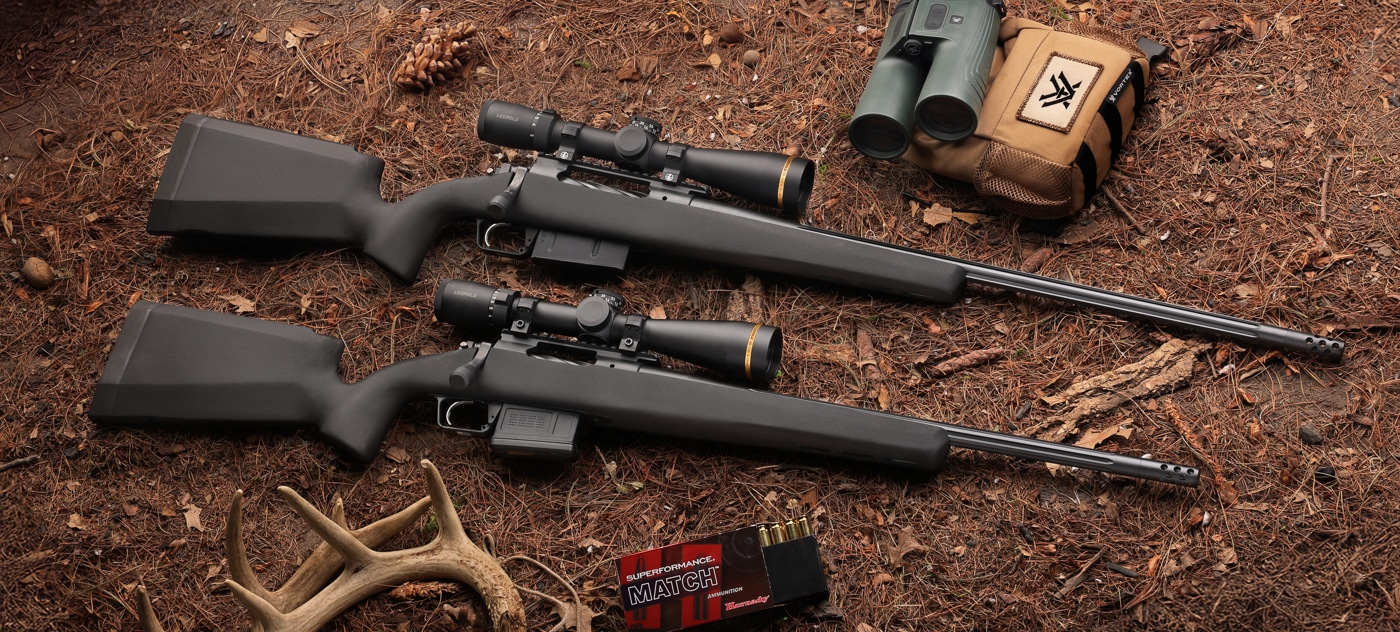

short action and long action versions of the Springfield Armory Model 2020 Waypoint with SG-100 Cerakote finish rifles next to each other
The short-action .308 Win. (bottom) wears a 20″ barrel, while the long-action chamberings stretch to 24″. Image: Carson McDaniel
The rifle is offered both a short-action (.308) and long-action (7mm PRC and .300 Win. Mag.) versions, and all three feature a high-quality, fluted stainless steel barrel. Topping off those barrels are 5.8×24 threaded with an SA Radial Muzzle Brake.
Machined with longitudinal flutes and measuring .74” just behind the muzzle threads, the barrel is heavy enough to soak up some recoil and shed heat while not being too heavy to carry. The barrel on my short-action .308 Win. rifle was a handy 20” long — perfect for maneuvering in the brush or the blind with the Dead Air Sandman-S suppressor I use. The long-action 7mm PRC and .300 Win. Mag. versions both feature 24” barrels.

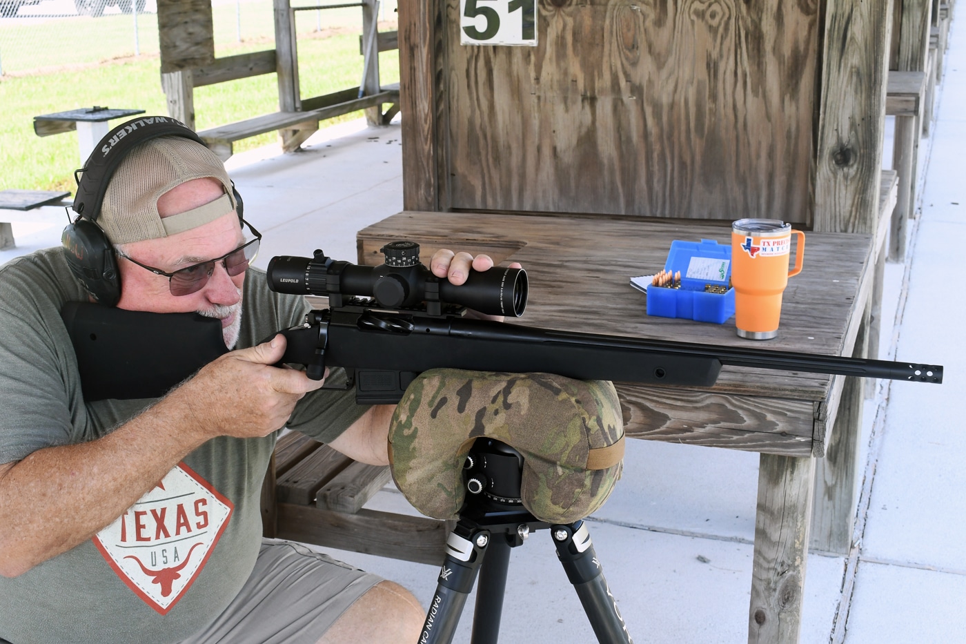

author shooting the Springfield Armory Model 2020 Waypoint with SG-100 Cerakote finish from a tripod for accuracy testing at an outdoor range
Tripod work is where the Waypoint’s balance and SG-100 stock coating really show their value. The tacky, velvety texture holds steady without feeling sticky in hand.

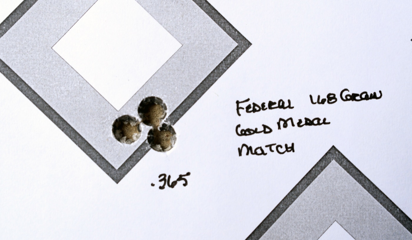

shot placement of Federal 168 grain Gold Medal Match ammo during accuracy testing the Springfield Armory Model 2020 Waypoint with SG-100 Cerakote finish
Federal’s 168-gr. Gold Medal Match turned in exactly the kind of performance the Model 2020’s accuracy guarantee promises with this ultra-tight group.

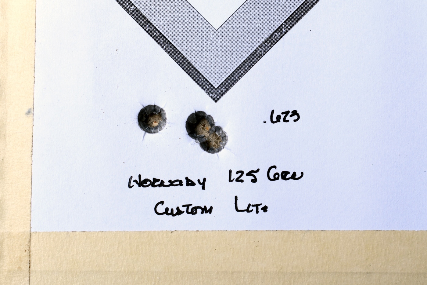

The Federal 168-gr. Gold Medal Match delivered the accuracy we expect, with groups that averaged under 2/3rds of an inch. The Hornady 125-gr. SuperLIte surprised us a bit with groups averaging in the half-inch range. My pet .308 reload, using Federal brass and match primers along with Varget powder topped by Sierra 168-gr. MatchKing bullets, hung right in there at a .64” average.
Springfield Armory Model 2020 Waypoint with SG-100 Cerakote finish range testing on paper target with Hornady SuperLite ammunition
Groups like this one are what you hope to see when a quality barrel and a good match load come together.
