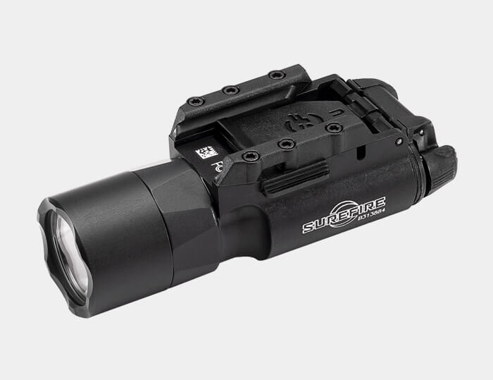

First of all, let’s go over some of the specs of this light. This light is bright with 1,000 lumens of total light output. It has a moderately tight spot with a measurement of more than 11k candelas and a beam distance greater than 200 meters.
Reviewing the Surefire X300U
The Surefire X300U has a moderately tight center spot with ample spill. This allows you to light up a room while still giving you some reach to illuminate a long hallway.
That’s a lot of power, so you might ask how long you can leave the Surefire on. Runtime to 10% of the initial output level is given as 1.25 hours.
The X300U-A light runs off of two 123A lithium batteries which are included when you purchase the weapon light.
It’s not as short as some gun lights, but it fits perfectly on a full-sized pistol like my Springfield XD-M Elite. This light is 3.6″ long, and it has an aerospace aluminum body that is anodized, which should make it durable enough for duty use.
Surefire seals the light against water intrusion. It is rated as IPX7 which means it is designed to withstand complete immersion to 1 meter for 30 minutes.

It has a custom Total Internal Reflection, or TIR, lens that creates a smooth, far-reaching light with a larger center spot beam that is ideal for close- to medium-range engagements.
Integral ambidextrous momentary- and constant-on switching provides easy instant activation. This light attaches to both Universal and Picatinny accessory rails.

Looking at the Surefire catalog, you will see a -A and -B model of this light. So, what is the difference between the two? Simple answer: the mounting mechanism.
The X300U-A uses a quick-mount mechanism for easily attaching the light to nearly any firearm with an accessory rail. This is the model I tested. You just pull down the two plastic tabs on the sides and it slides onto the rail.
Surefire X300U-A on Springfield Armory pistol
The Surefire X300U-A uses a quick attach system with two pull-down tabs on the body of the weapon light.
The -B model attaches with a more traditional screw fastener on the right side of the light. While I like the -A version, I can see that the -B variant might be a more solid connection for some pistols. With my XD-M Elite, the X300U-A was a perfect connection.
