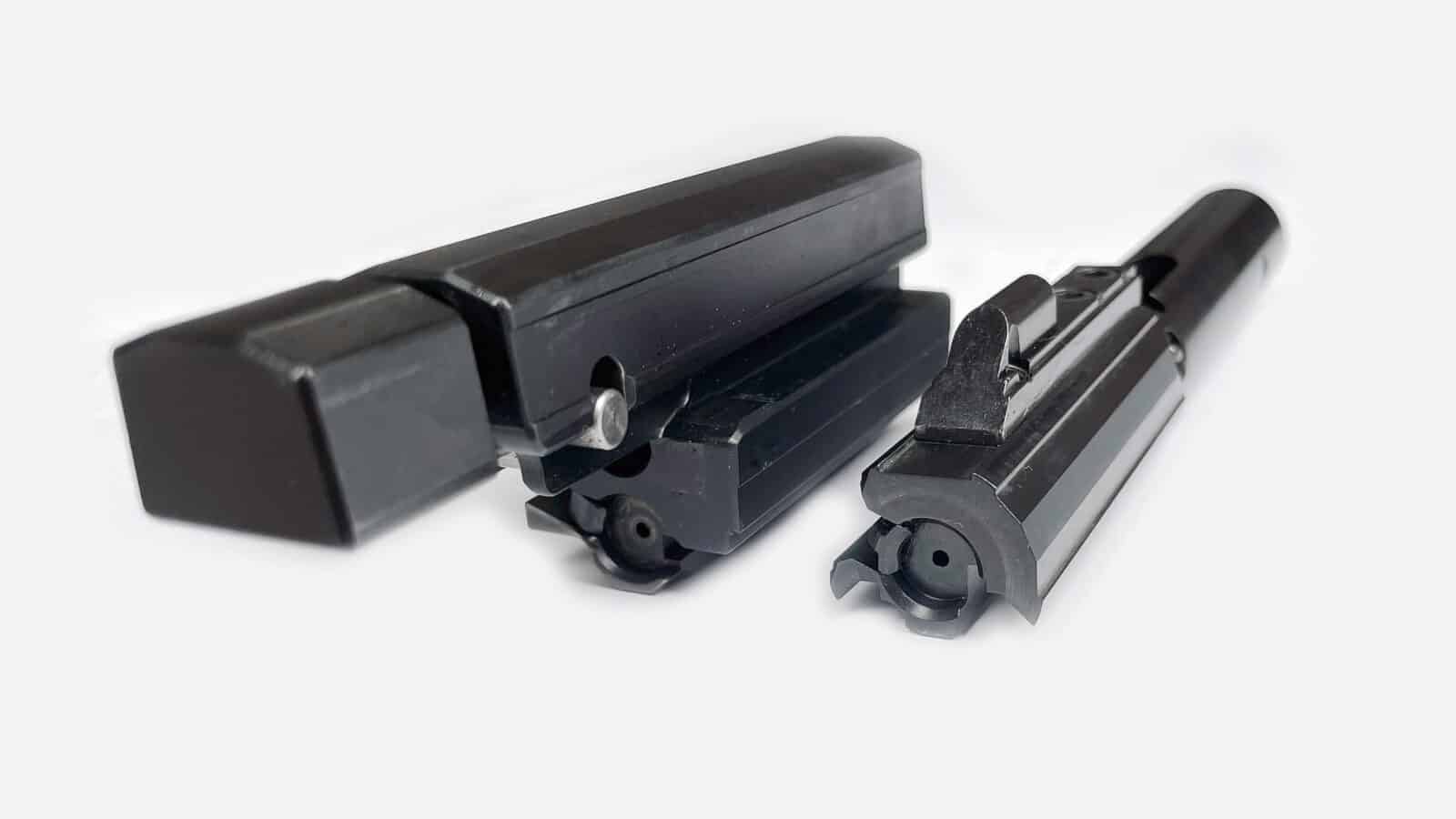

examples of roller delayed and straight blowback actions
Roller-delayed (left) and direct blowback (right) systems can both cycle a semi-automatic firearm, but the mechanics behind each are surprisingly distinct.

roller delayed blowback system in Springfield Kuna
That silver piece is the roller of the Kuna’s bolt carrier, and it’s doing a lot of work. It’s what helps give the Kuna its smooth recoil impulse.

straight blowback system in Springfield Armory SAINT 9mm pistol
This is the straight blowback system inside the Springfield Armory SAINT Victor 5.5″ 9mm Pistol — no rollers, no locking surfaces — just bolt mass and spring pressure doing the work.
In a roller-delayed blowback system, the bolt uses kinematic constraints, which are made up of a combination of a roller (or rollers) and a locking surface. As the round is fired and the bolt moves rearward, the force required to move these rollers from the recesses in the locking surface keeps the action closed long enough for chamber pressure to drop to safe levels.
The grooves act as the locking surface for the rollers, and the rollers create a mechanical delay with the bolt. As the pressure from the fired cartridge dissipates, the roller rolls out of the groove to allow the bolt to continue rearward, ejecting the empty case and cocking the hammer. Then, the recoil spring pushes the bolt forward, stripping the next cartridge out of the magazine and chambering it for the next shot.

Springfield Kuna roller delayed blowback action
The Springfield Kuna’s roller-delayed blowback action is a study in mechanical efficiency. Less bolt mass, smoother cycling, and a recoil impulse that feels noticeably softer.
The advantages of a direct-blowback system are utter and complete simplicity with fewer moving parts. It is also extremely easy to maintain. On the flip side, this type of design requires a large, heavy bolt and more perceived recoil when that mass is moving back and forth during cycling.
The advantages of a roller-delayed locking system is reduced bolt mass through the application of the roller lock, resulting in lower perceived recoil and very smooth cycling. However, it is a more complex design with more parts.

roller delayed action on left straight blowback on right
More mechanical complexity on the left (Kuna), pure simplicity on the right (Victor). Both are reliable and capable, but built around very different ideas.
